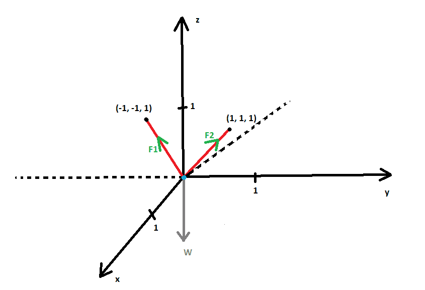

I tried to make a sketch of the problem...
Is this correct?? (Wondering)
Have I drawn the forces $F_1, F_2$, that we are asked to find, correct??
Yep. Looks good! ;)

Can we say that since the vector of the force $F_1$ is on the vector $(1, 1, 1)$, it is of the form $F_1(\lambda)=\lambda (1, 1, 1)$ and since the vector of the force $F_2$ is on the vector $(-1, -1, 1)$, it is of the form $F_2(\mu)=\mu (1, 1, 1)$ ?? (Wondering)
Yes to the first. (Nod)
No go the second. (Shake) (Nerd)
Oh... It should be:
Since the vector of the force $F_1$ is on the vector $(1, 1, 1)$, it is of the form $F_1(\lambda)=\lambda (1, 1, 1)$ and since the vector of the force $F_2$ is on the vector $(-1, -1, 1)$, it is of the form $F_2(\mu)=\mu (-1, -1, 1)$
right?? (Wondering)
mathmari said:
Oh... It should be:
right?? (Wondering)
Right! (Happy)
Is the way I formulated it correct?? Or could I improve something?? (Wondering)
Then we have that $$F_1+F_2+W=0$$ by the equilibrium condition, where $W=9.8 (0, 0, -1)$, right?? (Wondering)
$$\lambda (1, 1, 1)+\mu(-1, -1, 1)+(0, 0, -9.8)=(0, 0, 0) \\ \Rightarrow \lambda-\mu=0 , \ \lambda-\mu=0 , \ \lambda+\mu=9.8 \\ \Rightarrow \lambda=\mu=4.9$$
I'd write $F_1=λ(1,1,1)$ instead of $F_1(λ)=λ(1,1,1)$.
That's because $F_1$ is not a function of $λ$. It's a fixed value that has a relationship to the $λ$ that you've just introduced. (Nerd)
Yup! (Nod)
Ok... Thank you! (flower)
