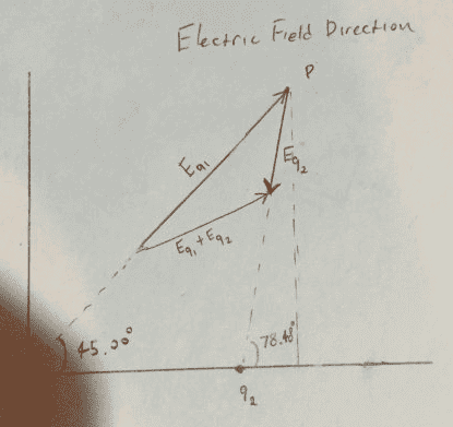

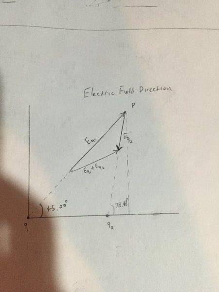

Charge q1 = +8.36 μC is fixed at the origin and charge q2 = -4.28μC is fixed on the +x-axis, 0.371m from the origin.
(a) Find the direction and magnitude of the electric field at a point P that has coordinates (0.466, 0.466) m.
(b) Find the direction and magnitude of the force on a -2.00 μC charge placed at the point P. (Please state the direction as an angle measured counterclockwise from the positive x-axis.)
E = Kq/r^2
Find θ1 = atan(0.466/0.466) = 45 degrees
θ2 = atan(0.466/0.095) = 78.48 degrees
I figured you just add the two vectors. For some reason I don't know how to... What is confusing me is that a can't use -4.28μC, for example, as the actual value. I think I need to use E=kq/r2 Here's what the diagram looks like
I really appreciate any helpEDIT:
I got the first part. It is attached
Would the second part just be F=Eq?

Hello josh12399 . Welcome to PF .
The resultant you have for E1 + E2 looks to be correct providing that you used correct magnitudes for E1 and E2. (You have placed the vectors in a rather unusual position relative to point P.)
What did you get for the magnitudes of E1 and E2 ?
