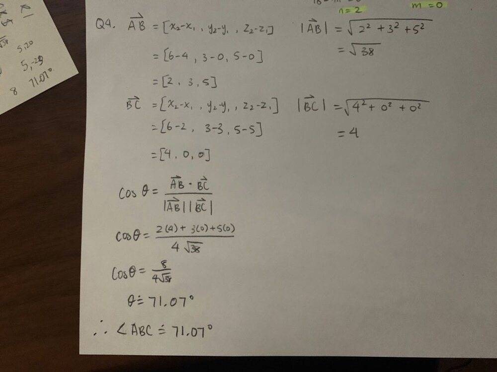

can someone see if my work is correct?
n/a
Handwritten working for Q4 finding angle ABC using vectors: AB = [2, 3, 5], BC = [4, 0, 0], cos θ = 8 / (4√38), θ ≈ 71.07°, ∴ ∠ABC ≈ 71.07°.
Photo of a printed exam page with a 3D diagram of a box-shaped solid with axes x, y, z and corner points A(4, 0, 0), B(6, 3, 5), C(2, 3, 5), D(6, 5, 3) and E at the origin, asking for angle ABC.
I think you made an error with calculating the vector ##\vec{BC}=[-4,0,0]##. I think you missed the minus sign here. You also want to consider ##\vec{BA}## instead of ##\vec{AB}##, so your solution checks out because two negatives cancel each other out.
Perhaps I'm misunderstanding your convention but I use ##\vec{AB}= \vec{B}- \vec{A}##.
