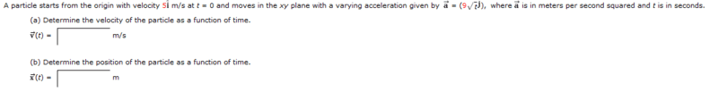

A particle starts from the origin with velocity 5 m/s at t = 0 and moves in the xy plane with a varying acceleration given by a = (9*squareroot*t)j, where "a" is in meters per second squared and t is in seconds.
Determine the velocity of the particle as a function of time.
Determine the position of the particle as a function of time
I have no idea
I have no idea

Hi!
So you first might like to recall how does one determine acceleration, velocity and all that:
Remember that:
[itex] \large<br /> \frac{d^2\vec{r}}{dt^2} = \vec{a}[/itex]
Split the components;
The acceleration is given only in the [itex]\hat{j}[/itex] direction, so that you're left with the simple task of integrating
[itex] \frac{dv_y}{dt} = 9\sqrt{t}[/itex]
Try it,
Daniel

i tried that, i didnt get the right answer, can u show me your steps?
Certainly!
Look here:
The velocity vector has two components, i, and j; in the i direction, it was initially constant, and with the abscence of acceleration in that direction it will remain so.
In in the j direction, after integration, we get:
[itex] \large<br /> v_j = \displaystyle \int 9\sqrt{t}dt = 9\frac{2}{3}t^{\frac{3}{2}}=6t^{\frac{3}{2}} [/itex]
[itex] \large<br /> v_i = 5[/itex]
[itex] \large<br /> v = \sqrt{{v_i}^2 + {v_j}^2} = \sqrt{25+36t^3}[/itex]
And in order to evaluate the position, all you need is a simple exercise in calculus for [itex]r=\displaystyle \int vdt[/itex], again, by integrating each fraction of the velocity separately, and r = sqrt(r_i^2+r_j^2) as before...
Daniel
