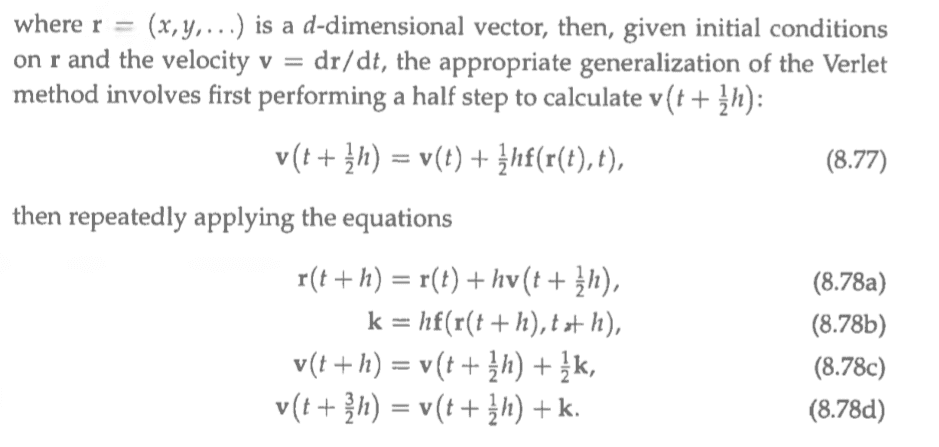

I am trying to understand the verlet algorithm but I am kind of stuck.
I guess first we are findind the ##v(t + 1/2h)## then we are leaving it there and starting a loop for 8.78 ?
Also I did not understand the meaning of the equation 8.78 ? We are never using ##v(t + 3h/2)## ? Or in the loop ##v(t + 3h/2)## becomes ##v(t + 1/2h)##

Yes, you calculate v(t + h/2) using the formula in 8.77.
No, there is no step 8.78, but there are steps 8.78a, 8.78b, and so on. And these steps aren't a loop -- you do them in succession. IOW, first you calculate r(t + h) as in 8.78a, then you calculate the vector k as in 8.78b, then v(t + h) and finally v(t + 3h/2).
Presumably there is some description of f(r(t), t) that isn't shown on the attached image.
Also part of the formula for step 8.78b is confusing in the 2nd argument to f. It looks like t + h, but maybe there is a smudge on the paper?
It's not clear to me, either. It would be a good idea to look up Verlet algorithm to see if you can find a clearer description.

Why are you doing this? There is nothing to be learned from looking at KE and PE separately and averaging them, the point is that the TOTAL energy should be CONSTANT at each step. The velocity verlet (and other leapfrog algorithms) are generally better at doing this than R-K methods because the error terms in the alternate 'half-steps' (8.78(a) and 8.78(c) in the extract you quoted in #3) tend to cancel out.
Why not go back to the R-K method and compare it side-by-side with the velocity Verlet to see how the total energy behaves? Also, run for 10, 100, 1000 orbits and see what happens.
