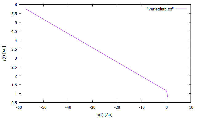

Hi! I am currently trying to write a code in C to simulate the orbit of planets around the Sun in the solar system.
I am using the velocity Verlet approach and finding that my code produces no acceleration in the ##y##-direction (aside from for ##t_n = 0##,) and that the planet just flies off to infinity without finding a stable orbit.

This code produces the following output graph:
Fig. 1
Output from broken simulation showing no stable planetary orbit.
Note that the Sun is placed at (0,0) and we are examining the Earth's orbit.

Is anyone able to see where my code is going wrong? Clearly these graphs do not show a stable orbit!

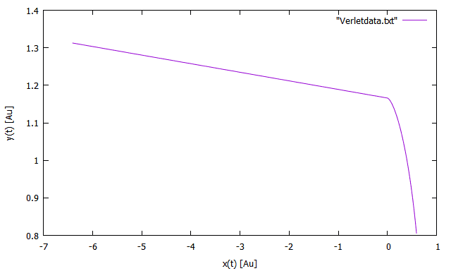

I was aware is had to be small but I didn't know it was that small! I've decreased it to about 1/10th of a day and it has indeed improved the accuracy. I am still getting similarly strange output, as follows.
Fig. 2
Output with timestep ##dt = 1/3650##.​

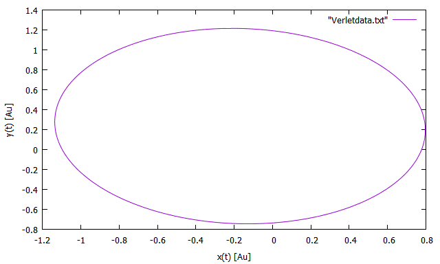

Thank you, these are all great pointers! I have updated my code to reflect this and will keep this in mind in future.
My code now outputs the following, which I assume will start working with the correct selection of initial conditions?
Fig. 3
Output with updating th[n].​

Your latest figure seems to point towards a division by a very small number.
I thought the same thing, too! But I can't seem to find where it would be, unless 1.0 Au counts as a small number for the initial position r[0]. If you can see anything blaringly obvious, my updated code is as follows:

Fig. 4
Complete orbit of the Earth around the Sun in 1 year.​
I have attached the full code as a .txt file for anyone interested.
