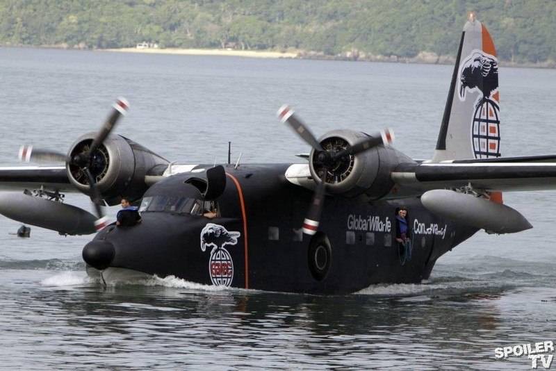

You mean the below?
Ronie Bayron said:
You mean the below?

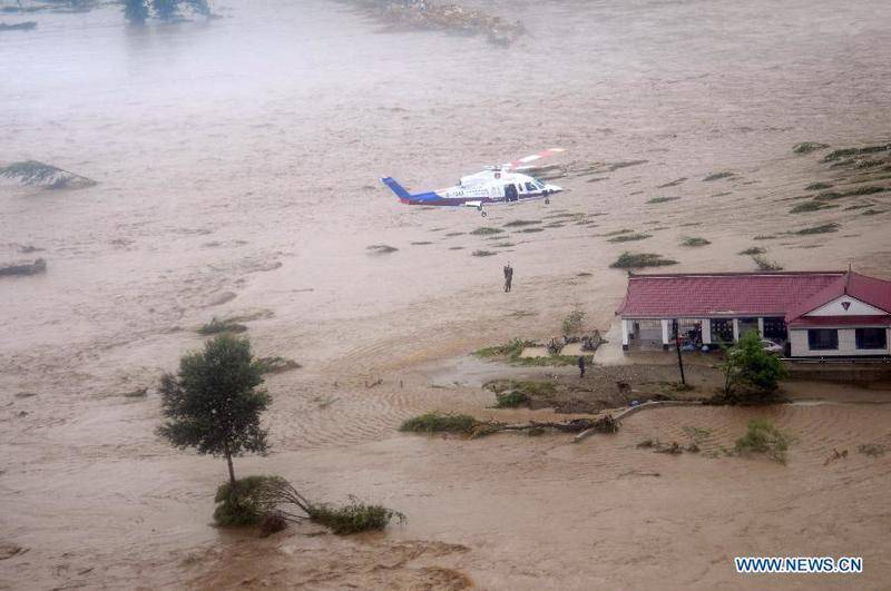

This is an amphibian aircraft so it can land and take off from water...but what about this below pic.
