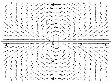

It does not in general, only if they are taken at the same point. Consider the solutions as trajectories through a vector field constructed by attaching the direction of the trajectory at each point. Then a solution is a flow through this vector field.
A second initial condition can either be one of the same trajectory at a different point, or one which directs in a different direction at the same point, and thus a second trajectory. And even if taken at a different point, we cannot directly tell to which trajectory aka solution it belongs.
O
So let me stick with the case where we resolve the solutoin at the same point (displacment and velocity I.C.)
You said "Then a solution is a flow through this vector field."
Those are nice words (please pardon an ostensible scarcasm -- I do not intend to be truly sarcastic, but only insofar as to manifest my ignorance). Why do those words demand the need for a second solution?
Later, you said: "or one which directs in a different direction at the same point, and thus a second trajectory."
OK, so I like the first clause, above, but I do not know why even that DEMANDS a second solution when the roots are repeated.
I feel there is something here that is important to understand about critical damping but I do not see it yet.
I neither know the equations you are talking about, nor the initial conditions and even less the vector field they define. Hence I can only give a general answer.
We have a real world problem, so tiny wobbles of the initial conditions can result in two completely different trajectories. In the image below e.g. a stable orbit or an ejection along the axis. Other possibilities occur, if the two solutions are independent. Then we have such a thing as two different vector fields within the same frame. Then chance decides which way will be realized in the real world.
E.g. we can have an equilibrium situation at a certain point, placing a pen on its peak. It will almost certainly skip, but it may also stay at rest until disturbed. Both are solutions of the same system. They have the different initial conditions at the same point of release: undisturbed or with some rest energy which causes the pen to skip, which is a completely different solution than the one with the pen standing up.
Equilibria can be classified by looking at the signs of the eigenvalues of the linearization of the equations about the equilibria. That is to say, by evaluating the Jacobian matrix at each of the equilibrium points of the system, and then finding the resulting eigenvalues, the equilibria can be categorized. Then the behavior of the system in the neighborhood of each equilibrium point can be qualitatively determined, (or even quantitatively determined, in some instances), by finding the eigenvector(s) associated with each eigenvalue.
An equilibrium point is hyperbolic if none of the eigenvalues have zero real part. If all eigenvalues have negative real part, the equilibrium is a stable equation. If at least one has a positive real part, the equilibrium is an unstable node. If at least one eigenvalue has negative real part and at least one has positive real part, the equilibrium is a saddle point.
