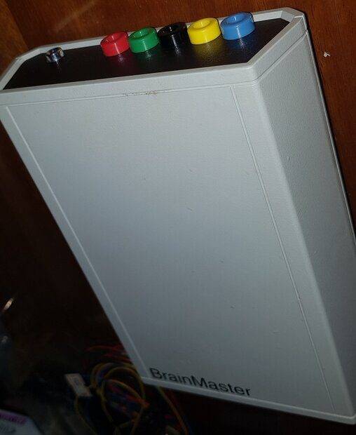

I got from my drawer last night a vintage Brainmaster 2E I bought late 1990s that I used only a few times during that period. It has serial port at back. I don't know if it will work using a USB to serial port adapter connected to my laptop. Do you think it will work?

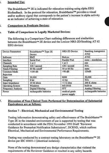

My question concerns the gain of the amplifier and the noise. It says above:
Notch Filtering: 40 Hz cutoff
Common Mode Rejection >100 dB
Gain 20,000
Sampling 8 Bit
Input Impedance 10 M ohms

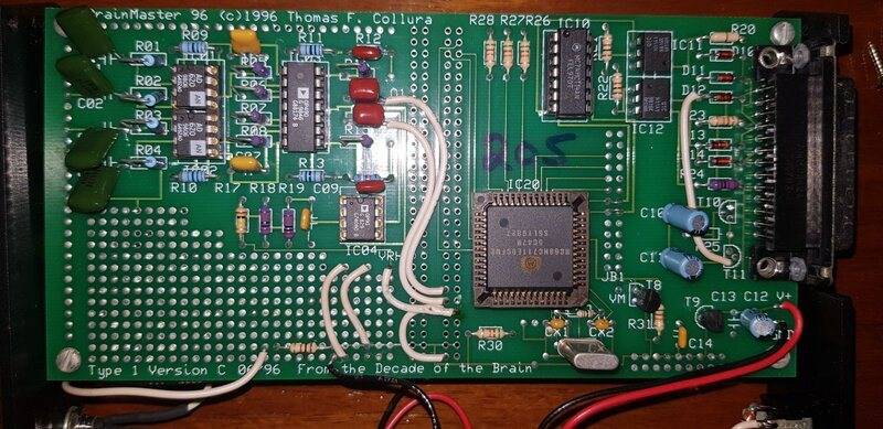

How does it compare say to your voltmeter? What is the gain of a regular voltmeter? It has this chip.
Familiar with it?
I just want to know how it compares to modern amplifier and whether it's worth taking the trouble to maybe buy an old pc to run it. Is it very ancient and maybe the gain of regular voltmeter is double it? Or still much less?
I think the serial interface can communicate with your modern computer if you buy the right adapter (I would be shocked if it wasn't RS-232). This is a pretty common problem and can be easily tested with a terminal app.
However, I doubt that the original SW will work, if you still have it. Lots of stuff written for Windows 3.1, Windows 95, etc. are toast now. IDK, maybe if you install a virtual machine? Writing your own code would require knowing what to say to this device, you'll need their SW interface docs, which I'm sure they never published (or even wrote).
