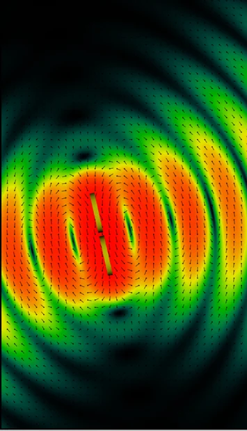

Hey everyone!
I recently built a real-time web-based simulation to help visualize the electric and magnetic fields radiated by dipole antennas:
https://antennasim.com
The simulation lets you:
• Add multiple dipole antennas anywhere on the canvas
• Set antenna phase and frequency
• Visualize the E-field, B-field, and Poynting vector in 2D
• Observe near-field and far-field interactions

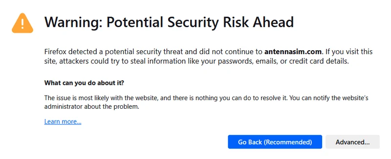

My web protection software blocks access to your link because it has an "unmatching security certificate".
Yeah, I'm getting the same error/warning.

It is incredibly interesting. I have plotted actual fields in this way using models. It looks rather as if your dipole is terminated in resistors because the E-field along the dipole moves progressively in the manner of a travelling wave. I wonder what your assumptions are about this? It is also interesting that the energy is initially contained within a cylinder rather than spreading in the figure eight pattern, and that is what I found. This is the slight near-radiation field effect of a dipole. As a consequence, I found that the Power Flux Density tends initially to fall with 1/D rather than 1/D^2. I need to look up my old measurements. I notice that your colours do not seem to display the true reduction in field strength with distance?
