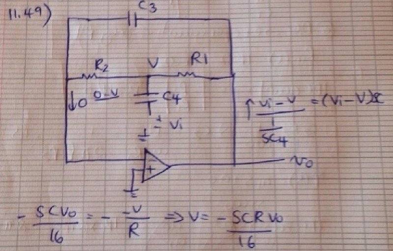

We have this feedback loop, with R1=R2 and C3=C4
hebergeur d image
I believe we should use KCL or KVL to solve the question.

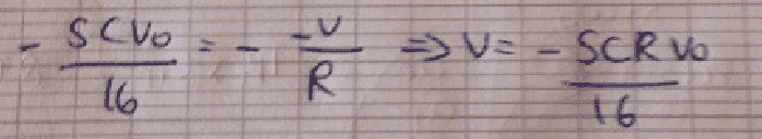

I didn't understand how this equation was found:
I tried KCL to find a relation between V0 and V but I didn't succeed to arrive to this equation
téléchargement de photos
Thank you guys in advanced!
I don't see where the "16" is coming from; You haven't supplied any part values or voltages.
Is the question statement complete?
