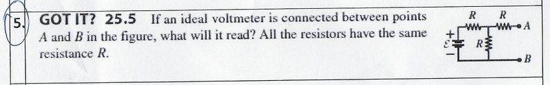

These are my two attempts at getting to the solution. I'm really finding it difficult to tackle this question (our teacher gave it as an optional challenge). The provided answer on the worksheet is ɛ/2, but I have no clue how to get there. Any help is much appreciated.
  • Textbook problem 25.5 'GOT IT?' with a circuit schematic: a battery of emf ε in series with resistor R, resistors R and R on the top branch, and points A and B across the right side, with a voltmeter question between A and B.

An ideal voltmeter is one that has infinite resistance. Use KVL, the resistor to the rightmost (nearest to terminal A) is short circuited anyway, so you are left with two resistors of equal resistance.
All measuring devices conncected to a circuit adveresly effect it, ideal ones dont. Since a voltage measurement is always made parallel to elements there must not be any current flowing into the voltmeter I believe, and this is achieved by having an infinite resistance. :-)
