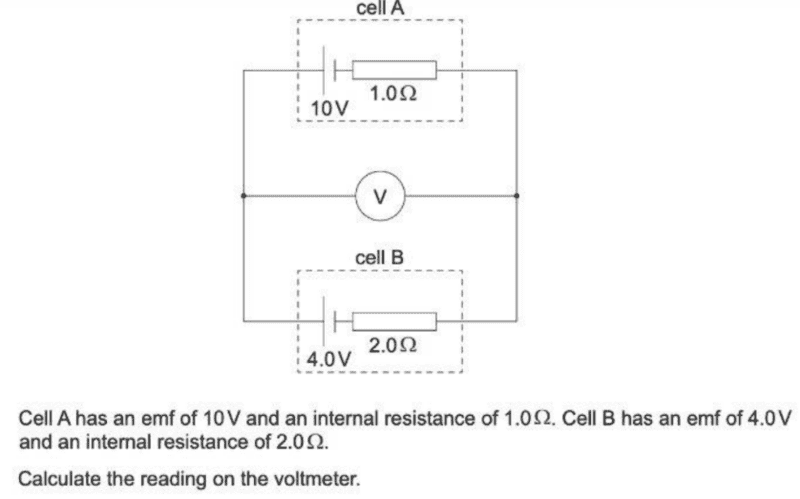

Calculate the voltmeter reading for this circuit with 2 sources and 2 resistors
5 replies · 2K views
songoku
2,521
395
Please see below
V = I.R
I find the current first, which is 2 A. Then the voltmeter reading would be 10 V - 1 x 2 = 8 V.
But the answer is 12 V.
I don't understand why it should be 10 + 1 x 2 = 12 V
Thanks
Yes, I agree, 8V is correct.
Current returning to cell A = x
Current returning to cell B = y
Current entering the voltmeter = z
10- 1*x=0
4- 2*y = 0
z = y + x
X=10
Y=2
Z=12
U=RI
1/R=1/1+1/2
1/R=1,5
R=2/3
U = (2/3)*12 = 8
The reading is 8 Volts.
