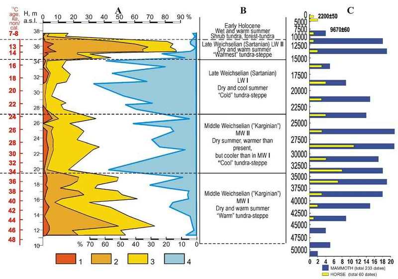

This chart depicts insect remains and bones rigtht in the middle of that area,
source: http://epic.awi.de/Publications/Hub2004a.pdf
Composite chart with four panels: depth-age profile of vegetation and climate zones with sediment labels, stacked area proportion plot (1 to 4), climate phase annotations, and bar chart of mammoth and horse radiocarbon date counts by age.
The caption reads:
Fig. 6. Summer climate changes and the dated record of mammals in the Laptev Sea area (from Sher et al., in preparation). (a) Fossil-insect record in the Mamontovy Khayata section, Bykovsky Peninsula. Percentage of selected ecological groups of insects (minimum number of individuals in each sample equals 100%): Thermophilous xerophiles: 1—steppe species; 2—other xerophilous insects (except tundra ones); Insects, currently common in tundra: 3—dry tundra inhabitants (prefer warmer sites); 4—Arctic tundra insects (plotted from the right axis). 14C ages in the left column are
calculated from two separate regression equations after about 40 AMS dates.
(b) Climatic and environmental interpretation of the insect assemblages from the Mamontovy Khayata section.
(c) Radiocarbon dates of mammal bones from the Laptev Sea area (number of dates in 2500-year intervals). The latest available dates for mammoth and horse are indicated at the top
Obviously there have been sudden and large changes in the climate of that area while the Milankovitch cycles are very gradually. Note also that sometimes summers used to warmer than nowadays

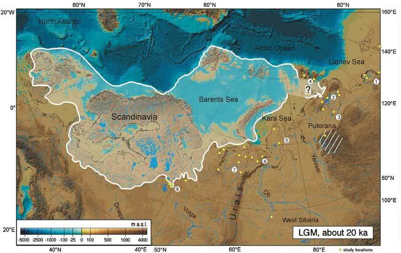

However this is the assumed maximum extend of the Last Glacial Maximum. some 20,000 - 15,000 years ago or indicated as 20 - 15 Ka BP (Before Present).
Map of northern Eurasia showing the extent of ice sheets at the Last Glacial Maximum, about 20 ka, with a white outline enclosing Scandinavia and the Barents and Kara Seas, a colour-coded elevation and bathymetry scale in metres above sea level, and yellow dots marking numbered study locations.
(Hubberten et al 2004 Page 1335)
Yellow dots are the research sites. Note that several mammoths have been found in the far north around "2"

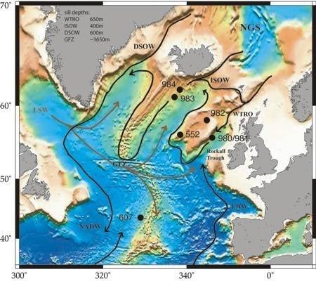

Maureen Raymo makes an interesting comment on the Thermohaline Circulation of the North Atlantic. http://maureenraymo.com/current_projects.php
  • Bathymetric map of the North Atlantic with labelled deep-water currents (DSOW, ISOW, WTRO, NGS, LSW, NADW) and numbered core sites 607, 552, 982, 983, 984 and 980/981 plotted across the ocean floor.

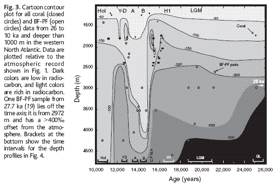

Contour plot of coral and BF-PF radiocarbon data by depth (m) against age (years, 10,000 to 26,000), with contour labels and period brackets Hol, YD, A, B, H1 and LGM along the top and bottom.
Edit periods mentioned in the graph:
Hol is Holocene
YD is Younger Dryas
A is Allerod
B is Bolling
H1 is Heinrich event #1 (massive ice berg rafting)
LGM is Last Glacial Maximum
We see here that in the ice ages the radiocarbon (14C) in the CO2 of the ocean waters was pretty stratisfied. Most in the higher layers, depletion in the bottom waters. To me that means that the bottom waters were very old and did not hardly mix (radiocarbon decayed without replenishment). We see gradual changes, apparently Then suddenly, almost overnight, things changed at the beginning of the 'warm' Bolling Allerod stadial at around 14,500 years ago and again during the 'cold' Younger Dryas oscilation. also it looks a lot faster than the normal ocean inertia. But we end up with well mixed 14C in the waters. I wonder what forces were required to get these changes.
It's from here:
Robinson, L.F, J.F. Adkins, L.D. Keigwin, J. Southon, D.P. Fernandez, S-L Wang, D.S. Scheirer 2005 Radiocarbon Variability in the Western North Atlantic During the Last Deglaciation, Science, Vol 310, 2 December pp 1469-1473
We present a detailed history of glacial to Holocene radiocarbon in the deep western North Atlantic from deep-sea corals and paired benthic-planktonic foraminifera. The deglaciation is marked by switches between radiocarbon enriched. and -depleted waters, leading to large radiocarbon gradients in the water column. These changes played an important role in modulating atmospheric radiocarbon. The deep-ocean record supports the notion of a bipolar seesaw with increasedNorthern-source deep-water formation linked to Northern Hemisphere warming and the reverse. In contrast, the more frequent radiocarbon variations in the intermediate/deep ocean are associated with roughly synchronous changes at the poles.
http://www.whoi.edu/cms/files/Robinson_Science_2005_21687.pdf

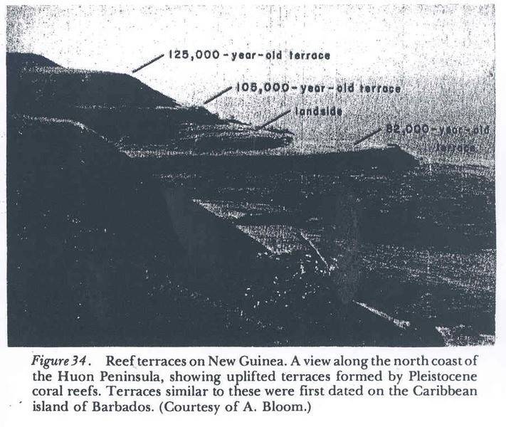

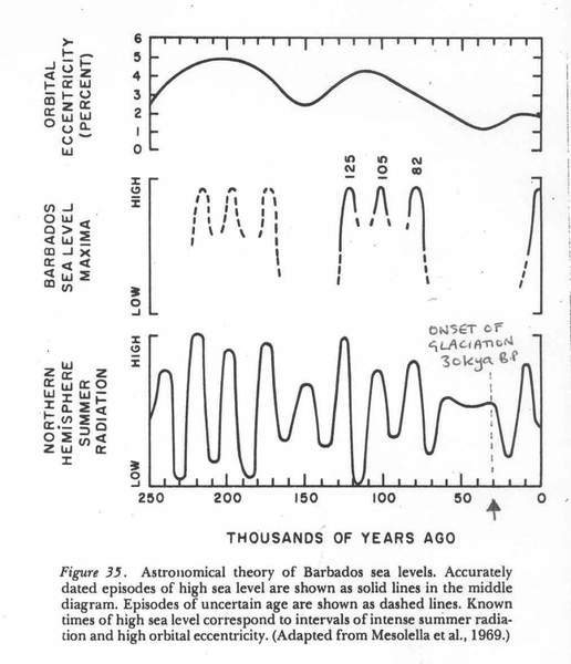

Sustained high sea levels are recorded by the formation of coral terraces. These are times of low glaciation, since the seawater is not 'locked up' in the form of snow, and advancing the ice sheet. The three terraces given below match up with times of high summer radiation, implying that winter snowfall in the higher latitudes was all melted during the warm summer temperatures.
  • Photograph of reef terraces on the Huon Peninsula, New Guinea, labelled 125,000-year-old terrace, 105,000-year-old terrace, landslide and 82,000-year-old terrace, with stepped uplifted coastal ledges.
  • Three-panel graph of orbital eccentricity, Barbados sea level maxima, and northern hemisphere summer radiation against thousands of years ago from 250 to 0; annotation reads ONSET OF GLACIATION 30kya BP.

Firstly, thanks for the interesting report which challenges Imbrie & Imbrie's coral terraces graph that I gave earlier. I wasn't aware of this angle of debate, although I quickly knew what was causing the confusion. The first line of the report goes:
"According to the Milankovitch theory, changes in the incident solar radiation, called insolation, in the Northern Hemisphere provide the driving force for global glacial cycles."
This pre-supposes that the forcing mechanism due to changing eccentricity is solar radiation. This is where the confusion lies. There is a possible second mechanism for global temperature forcing which is independent of insolation. This is due to gravitational tidal force. It is only the amplifying mechanism which is unknown. I have a simple but effective speculation which would account for this amplification. It is linked to the 'gravity problem' in physics. If it is assumed that the gravitational acceleration of the Earth is non-linear in response to the Sun's gravitational field, much larger changes in tidal force are possible with changing eccentricity. The non-linearity is due to the increasing entropy of matter towards the center of the Earth. This means that matter is 'more orderly' at the inner core, and so will experience a greater gravitational pull compared to the ordinary baryonic matter of the outer Earth. When the Earth is closer to the Sun, even by only a few percent, a much larger Earth bulge is possible than previously thought by conventional wisdom. Therfore a new name needs to be applied to this idea, since it isn't just insolation which is the proposed driving force but a combination of insolation and tidal force. Perhaps it should be called Milankovitch-Mammo theory. The effect of this largely varying tidal force is further complicated due to the combined effect of ocean currents. This means that further amplification is possible due to the transport of heat from the equator to the poles. It is the re-distribution of heat via ocean currents which is the main driving factor in the 100,000 eccentricity glacial cycle.
The idea can also be used to explain the millennial cycle of unknown origin and driving force. The 1,800 year oceanic tidal cycle was explored by Charles D. Keeling and Timothy P. Whorf. http://pangea.stanford.edu/research/Oceans/GES205/1800yrTidalCycleForcingAbruptClimateChange.pdf
