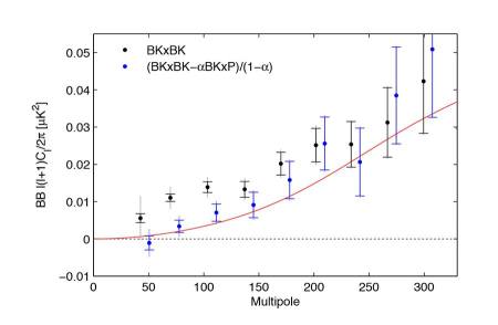

To elaborate on the "wriggle room" for Gravitation Wave Background (GWB). From Peter Coles' blog: In the diagram below the black dots with error bars show the original BICEP/Keck “detection” of B-mode polarization which was assumed to be due to primordial gravitational waves, while the blue dots with error bars show the results after subtracting the correlated dust component. On top of which the red curve shows the known B-mode polarization signal that is generated by gravitational lensing.
Note there’s a slight, not statistically significant, hint of a GWB excess over the red curve at multipoles of order 200, where the error bars are larger.
