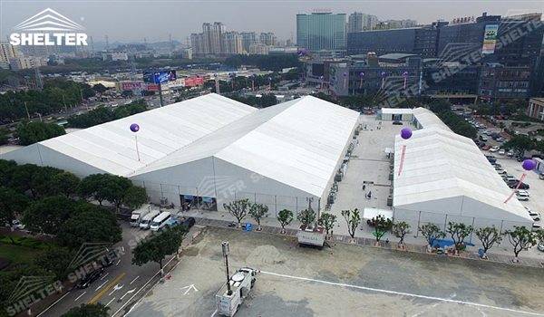

Alternately, 25 Acres of white tenting material might help to drop the water temperature. Again, the cost and scale may not be practical, but it might be worth considering... Also, do you need to support fishing in all 10 ponds, or could you just support it in 1-2 ponds and move the fish from the other ponds to the fishing ponds as they get depleted?

@berkeman has an idea with the tenting. But I think you would need it without the walls to get enough air circulation to avoid heat build-up - essentiall a very big umbrella to block the direct Solar heating.

This would need to be combined with a huge amount of ventilation, otherwise you are just trapping humid air and preventing evaporative cooling.
Agreed, that was an oversight in my post. Thanks guys! :smile:
