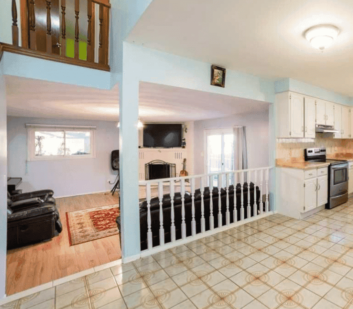

It's a 5-level backsplit. Wife and I will be in back/basement, kids and grandkids will be in front/2nd floor.
So, the first thing we're going to do is build a wall between the upper flat and the lower flat - where the railing is. The entrance to the left wll become a door.
Open-plan split-level interior: a white railing with spindles runs along a raised step above a black leather sofa, with a fireplace and wall-mounted TV in the lounge beyond, and a white-cabinetted kitchen with a range on the right.
So, they will be in their kitchen, right behind our heads when we're on the couch. And they are not quiet people.
We want it to
- be sound-damping
- be translucent to provide privacy.
- yet allow light in
We think glass block would be perfect but, for some reason, DIL does not like glass block walls.
Any suggestions for alternate arrangements that block sound but not light?

If your primary concern is quite,
I would put in a wall that will have significant sound damping.
Glass blocks seem pretty dense to not transmit sound to me, but I have never tested this.
A thick drywall wall with a lot of non-rigid insultation would be cheap and easy.
Replacing some of the wall with sound-proof windows might satisfy your other concerns.
They are filled with air.
"Standard 80mm thick glass blocks provide a weighted sound insulation index of 40/42dB."
"Depending on the type of glass block selected, features such as mass and internal air space guarantee that these blocks offer a high level of sound insulation, which is a minimum of 36 dB. There are glass blocks that can even reach 51dB sound barrier."
