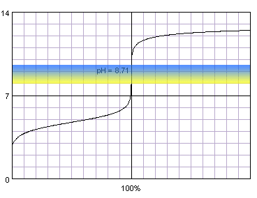

I find the henderson-hasselbach equation very hard to visualize. The log of the fraction part throws me off. If I was to graph a weak acid strong base titration and plot the pH on the y-axis and amount of base added on the x-axis would I see a slow rise in pH until the amount of base added equals the initial amount of weak acid added (in other words when base has completely neutralized the acid) then the pH would begin to rise rapidly?
(taken from titrations.info/acid-base-titration-end-point-detection)
This is acetic acid titrated with NaOH. You start with a sharp rise at the very beginning, followed by a flat part (described by Henderson-Hasselbalch equation). Once the buffering effect ends, pH skyrockets.
Yellow-blue band is about indicator color change (thymol blue).
