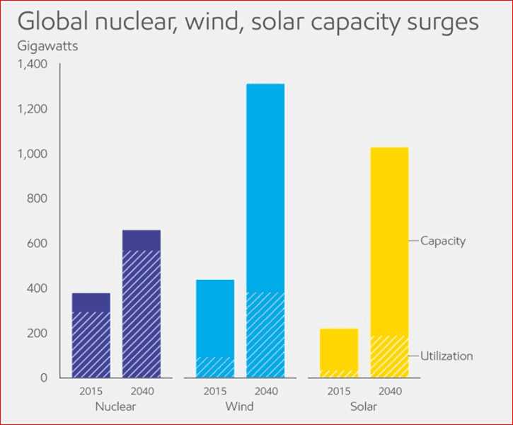

etudiant said:
Likewise, there is no doubt the fossil fuel industry is aggressively anti nuclear, in Germany as well as elsewhere. Their opposition stance got a lot wider following because of the nuclear industry's own failures and lack of credibility.
I don't believe that is so.
http://corporate.exxonmobil.com/en/...017/global-nuclear-wind-solar-capacity-surges
Bar chart titled Global nuclear, wind, solar capacity surges, showing gigawatts of capacity and utilization for 2015 and 2040. Nuclear rises from about 380 to about 660 GW capacity; wind from about 440 to about 1,310 GW; solar from about 220 to about 1,030 GW.
