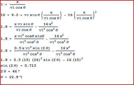

A basketball player is 15ft horizontally from the centre of the basket which is 10ft off the ground At what angle should the player aim the ball from a height of 8.2ft with a speed of 26fts^-1?
[itex]x = vi cos . t[/itex]
[itex]t = \frac{x}{vi cos Θ}[/itex]
sub t into y(t):
1.8 = [vi^2 sin2Θ - gx^2]/2vi^2 cos^2 Θ
Θ= 22.6
The answer stated solution to be 66°

Y(t) is the y displacement as a function of time.
It has the form yf = yi + vyi. t - 0.5gt^2
t= x/ vi cos (theta), vi=26ft/s, yf=10, yi=8.2 and g = 32ft/s^2
I sub t and the known variables into the above equation. What I got was 22 degrees. But this contrasts with the book's
Funny, I substitute t = x/(vi cos(theta)) in vyi * t with vyi = vi sin(theta) and get x * sin(theta)/cos(theta) !? You can change to 2theta which should introduce a 2 (which you do take into account) but it shouldn't let the x disappear !

Where is your vi? Shouldn't it be x.vi sinΘ/vi cos Θ?
vi/vi = 1

The answer doesn't tally with the book's
I see you multiply by vi^2cos^2(theta) on the righthand side. To keep the equality valid, you have to do so also on the lefthand side. I.e. the 1.8 changes...

Quite so, but I don't think this approach is leading anywhere.

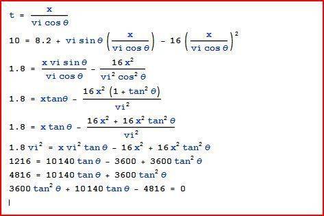

negation, go back to the third line of your attachment: "1.8 = " etc.
sin/cos = tan; 1/cos2 = sec2.
Using sec2 = 1 + tan2 you get a quadratic in tan.

I get a much larger angle. Please post your working.

haruspex said:
6th line (1.8 vi2 = ...), check the sign on the tan2 term.
Ought to have been a negative
Did you got 72.8?
No, should be 65.67 degrees if g = 32
Filling in 72.8 doesn't satisfy your final equation with the corrected sign: some 9630 off!
A check you should always do (if you have time enough)
