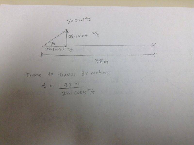

Remember, if the arrow is flying at an angle [itex]\theta[/itex] its horizontal velocity will be [itex]23.1cos(\theta)[/itex] Use this to solve for the time it will take the arrow to travel the distance of 38 meters. It should end up being [tex]t = \frac{38}{23.1cos(\theta)}[/tex]
Hopefully this will push you in the right direction.
After looking into it a bit more, I have some concerns about the triangle itself. In the initial case (when the arrow was shot 13.3m below the target), there was no vertical component to the overall initial velocity. If we add a vertical component, don't we have a smaller X initial velocity then? Or will it remain 23.1m/s?
This is what the second part of your problem should look like so far.
Handwritten diagram: a velocity vector of magnitude 23.1 m/s at angle theta to horizontal, with components 23.1 cos theta m/s horizontal and 23.1 sin theta m/s vertical, above a 38 m horizontal line. Below: Time to travel 38 meters, t = 38 m / (23.1 cos theta m/s).
That is correct: the arrow will have a smaller horizontal component as the angle increases.
That is what whdahl's equation is telling you too.
