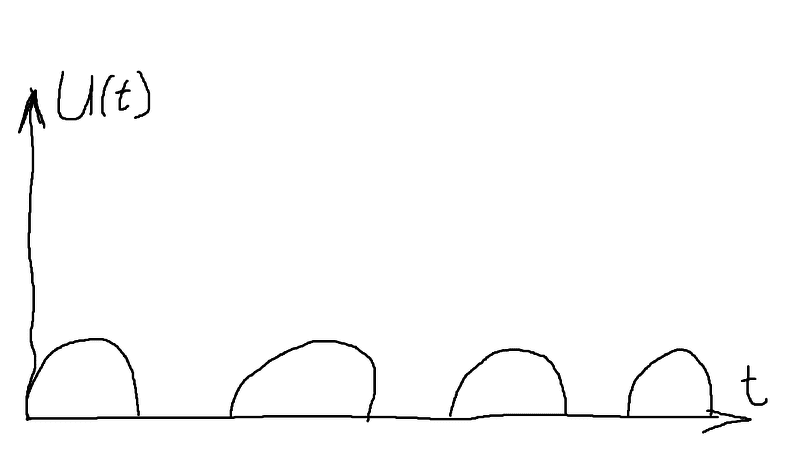

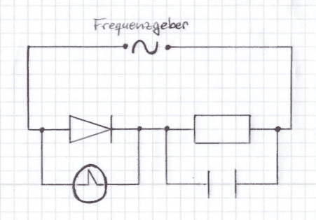

Hello!
for the easy circuit 1 i see that the diode does cut out every half of the sinus wave in alternating current.
("Frequenzgeber" means frequency generator)
the device with the peak symbol is an ozilloscop.
i don't understand what happens with the voltage U(t) in circuit 2.
what does the condensator do with U(t) ?
is there any name for it?

hi part
An RC circuit is a filter
now without giving you direct answers do some investigating. Here is one place to start ...
http://en.wikipedia.org/wiki/RC_circuit
have a read and maybe on a couple of other www sites on RC networks and come back and let us know how you got on.
Any mis-understanding? then ask some specific questions pertaining to what you find :smile:
Dave
Think of the capacitor/condenser as a charge storage device (bit like a rechargeable battery).
I would also redraw the circuit like this..
http://pics.bbzzdd.com/users/mrdudeman/filter.JPG

Yes i know the RC circuit as a filter but isn't it a different setup here? :)
I would say its not functioning as a RC circuit because here R and C are parallel and not in a row.

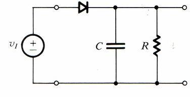

Circuit schematic of a half-wave rectifier: an AC source on the left feeds a diode, then a capacitor in parallel with a resistive load on the right.
OK your 1st cct is just showing a 1/2 wave rectifier and a resistive load
the 2nd cct, and when viewed more conventionally, as above, the capacitor provides smoothing
or if you like some filtering of the remaining AC signal that is present across the resistor load
have a look at this link and see if it helps ...
http://www.electronics-tutorials.ws/diode/diode_5.htmlcheers
Dave
  • Circuit schematic of a half-wave rectifier: an AC source on the left feeds a diode, then a capacitor in parallel with a resistive load on the right.

This is the diagram I tried to post earlier.
  • Circuit schematic of a half-wave peak detector: source v_I in series with a diode, feeding a capacitor C in parallel with a resistor R across the output terminals.
In this case I think it's quite acceptable to refer to the RC as having a filtering function even if the RC is in parallel.
Yes agreed, I even found one place on the all about circuits site that spoke of RC series and parallel ccts and the conversion from one to another when looking at their equivalence
