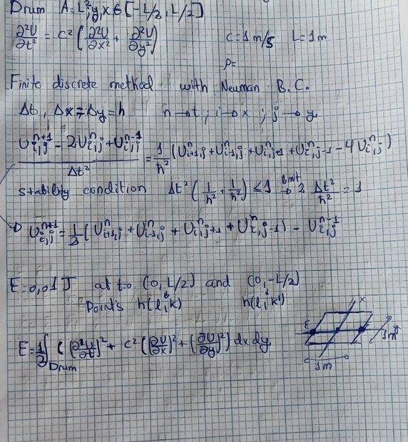

The statement of the problem is as follows: A square drum with side L=1 is at rest until two drops falls over it . The wave propagation veclocity is c=1m/s.The drops injects E=0.01J into the system at t_0=0 s. The boundry conditions are Neuman's.
The problem im having is with the initial form of the drums membrane. How should i write the initial conditions( visually the grid points where the drops impacts should elevate a little bit ( it can be thought of dirac delta ) and then the wave will propagate from both ends ) knowing the integral form of the energy???+
The problem asks for the form of the membrane after 2 seconds, this should be quite easy if I can write the initial conditions.
Wave equation
I am having problems writing the initials conditions.
