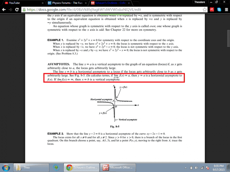

1. Homework Statement
Draw graph of the following equation
[tex]\frac{X-5}{X^2+X-6} = y[/tex]
my problem is searching for the vertical asymptote
from what I know the way to find the vertical asymptote is by limiting the equation near to ∞. and based on my calculation, the vertical asymptote should be 0
but when you put X=5, the graph will show that it crosses (5,0)

I do know that vertical asymptotes are where the function grows indefinitely large at nearby values. and it will reache the value of the asymptotes when X=∞
from what I read at Schaum's outline book, you can find the vertical asymptote by using ## \lim_{n\rightarrow +\infty} f(X) ##
I use this formula and get 0 as the answer
No -- that's a horizontal asymptote.
I did put the wrong value, sorry for my mistake. I am recalling it from my memory
anyway, when I insert X=5 it reaches the value 0
I doubt very much that the Schaum's outline book tells you to take ## \lim_{n\rightarrow +\infty} f(X) ##, because that expression makes no sense at all, and Schaum's outlines are never so careless as that. There is a difference between horizontal and vertical asymptotes; do you know how to distinguish between them?
On the substance, you can easily factorise the denominator and that should hopefully immediately reveal to you a lot about the 'vertical asymptotes'.
For starters, look at ##y = \frac1x##. This has a vertical asymptote at x = 0, since it is undefined at this value and for very small x, 1/x is very large.
Your confusion earlier, as Mark pointed out was that you were using the definition for a horizontal asymptote instead of the one for vertical.
The horizontal asymptote of 1/x is y=0. Which the function never reaches but nears as x gets very large.
Note that vertical asymptotes are almost always defined by values of x where the function is undefined...you may have covered these in exercises about the domain of a function.
## \frac {X−5} {X^2+X−6}=y ##
my problem is searching for the Horizontal asymptote
from what I know (froum schaum's Outlines College Mathemathics 3rd Edition) the way to find the Horizontal asymptote is by limiting the equation near to ∞. and based on my calculation, the horizontal asymptote should be 0

theo12349 said:
Yes, that's correct. It is also useful to find the limit of this function as x approaches -∞. Some functions have different horizontal asymptotes as x → ∞ and as x → -∞.
The horizontal asymptote indicates behavior for very large values of the independent variable x, or for very negative values. The graph can still cross the x-axis at reasonably small values of x, such as x = 5.
theo12349 said:
[sorry for my english]
How does your graph look? There should be two vertical asymptotes and you should be able to determine where the horizontal asymptotes are for x going to positive and negative infinity. I mean, is the plot above or below the horizontal asymptotes in the limit?
You should be able to describe the plot generally by its behavior near these limiting and critical values.
