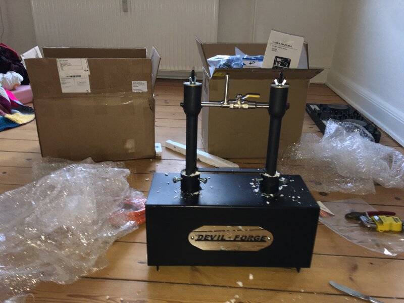

Well, in an uncontrollable fit of shoveling money out of the window I think I actually managed to order a propane blade forge and a plasma torch.
I'm not completely sure if the plasma thingy I ordered is a plasma cutter only, and capable of nothing else, but we'll see. It was quite expensive but not excessively so, and looked quite effective. Menacing even.
The forge (which can be opened at both ends) is a blade forge made of steel with 2 propane flames, which I'm sure will be practical if I decide to make a Spartha or Katana as my first project.
Yes, I know: In actual fact my first project will - with luck - be a door stopper, or if I'm really really lucky maybe a beer opener.
I'll post some pictures when I get around to it.
