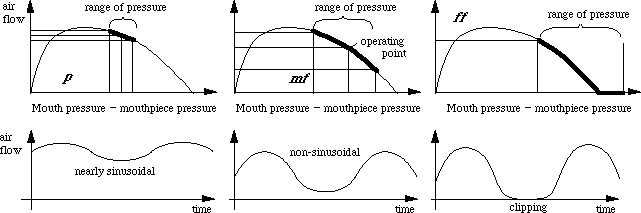

dlgoff's #17 is interesting, because it shows how a nonlinearity enters in the case of a reed instrument. However, it's not obvious to me how that nonlinearity produces overblowing.

The tube does not just choose the note within a wide noise spectrum or between several harmonics produced independently by the reed or blowhole. It determines how the reed or blowhole behaves to create just the emitted note.
Easier to understand with a reed. During one oscillation period of the air column, when the pressure is minimum, it attracts the reed to close the mouthpiece, thus reducing the air throughput. When pressure is high, the reed is pushed open to increase the throughput. The reed that brings air when pressure is high brings the negative impedance that let's the air column oscillate by providing power to it.
For this, the reed must act as a spring, not a mass. In other words, its resonant frequency must be quite higher than the emitted note.
In a blowhole, the negative impedance relates with the time needed by air to cross the hole (hence the air pressure). It's similar to some power vacuum tubes: pressure deviates the air jet, but once the jets arrives at the bevel, the pressure has already changed, hence the negative resistance.

The part with negative conductance the creates the oscillation has also a susceptance. This is personal thought, not widely known. Again easier to grasp at a reed than a flute, and can be experimented convincingly when playing a saxophone, or even better a bassoon.
As higher pressure in the tube pushes the reed away, the mechanical movement also increases the air volume in the tube. This is equivalent to a capacitance. Not a small one: similar to the tuning volume in a saxophone's mouthpiece, or to its missing volume at the truncated cone.
This susceptance is in parallel with the reed's negative conductance and with the admittance of the air column. It influences the pitch AND the overblow.
A harder reed (best combined with a less open mouthpiece) needs more pressure for the same movement hence produces a smaller susceptance. Same for a narrower reed and mouthpiece. They pitch the instrument higher. Little bit at the clarinet, important at the saxophone, huge and obvious at the bassoon, where musicians tune the reed by cutting it.
It is this susceptance that prevents the instrument from overblowing when not desired. The susceptance must be big enough to short-circuit the negative conductance, so that the reed can't compensate the column's losses at the harmonic, and oscillation occurs at the fundamental only.
Now, if you press the reed more firmly, first the pitch rises because the free-moving part of the reed is shorter hence the reed's susceptance decreases, and then the note jumps to the overtone.
Which means that the reed and the mouthpiece must match the instrument. With parts from an alto saxophone, you can't overblow a bassoon.
Back to the wide toneholes: timber gets bad when the reed is too efficient, because the reed closes and opens too brutally then. Similar to a bagpipe then.
The musician adjusts his lip pressure for that, but only if the instrument allows it. The losses at the air column must match approximately the reed's negative conductance. As the closer reed is needed to produce higher notes, the negative conductance changes, and the tube's losses must still match the reed and mouthpiece. This is true when bridging to the second mode, and needs shorter notes to have narrower holes than long notes - can be observed at real instruments.
This equilibrium would be necessary when playing soft and loud. The clarinet achieves it, the saxophone doesn't.
Narrow holes also de-tune the higher harmonics which then are attenuated as they don't resonate any more. Softer sound, emission less easy. Harmonics alignment is knowingly paramount to make an easy instrument, but because the reed's susceptance varies with the note, the manufacturer can't tune the overblow perfectly and align the harmonics.
Octave holes help a lot by killing the resonance at the fundamental (or generally the unwanted mode. Early saxophones had independent octave keys that helped the third overtone if wanted).
For that, the opening doesn't suffice, as it would only change the pitch. They must also bring losses big enough to prevent oscillation, even though the reed would provide the negative conductance. This part is better documented in books.
Cross-fingerings can be partially understood as better octave holes, always at the optimum location, possibly combining several of them, to define strongly the allowed vibration mode.
But they're more. As the frequency increases, tone holes get less efficient in producing a short-circuit, because of their inductance - more so if they're narrow. More well-situated open holes add their effects to produce a good sound reflection, while closed holes in between keep the vibration.
At higher notes, the length corrections by the tone holes and the reed and mouthpiece are huge, so the distance between the cross-fingering holes is easier to compare with the note's pitch.
