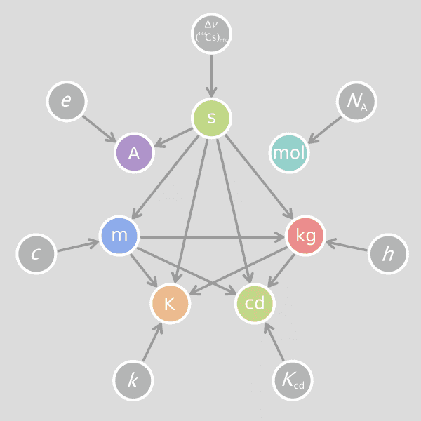

BTW I hope you take a look at the Wikipedium about the PROPOSED CHANGE IN THE METRIC SYSTEM, that could be voted in in 2018 at the next big meeting.
http://en.wikipedia.org/wiki/Proposed_redefinition_of_SI_base_units
It proposes to define the metric units by assigning exact values to a handful of physical quantities.
So it will no longer be possible to measure Planck's constant because it will be assigned an exact value as part of a strategy to define the kilogram.
Nor will it be possible to measure the charge on the electron because it will be assigned an exact value as part of a scheme to define metric units like the Ampere and the Coulomb. the Amp will be defined as so and so many ELECTRON CHARGES PER SECOND. Solid state devices can count electrons flowing thru a junction so why not?
I think this gets at what you were asking about. What physical quantities are fundamental?
One sign that a quantity might be fundamental is if the Metric governors decide to assign it an exact value as a technique for defining units. The criterion doesn't always work, convenience is a consideration, but it's something to take note of.
It is already impossible to measure the natural unit speed (the speed of light in vacuum) because it has been assigned the exact value of 299792458 meters per second, as a way of defining the meter.
Here's the more general proposed scheme for redefining the metric units. You can see which natural quantities besides c get assigned exact numerical values. Avogadro number, electron charge etc...
Wikipedia graphic contributed by someone named "Wikipetzi". Thanks.
