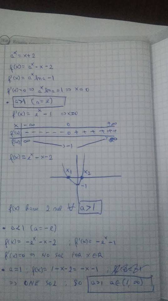

Sorry for posting again but I need to prepare for exam.
a^x=x+2 has two real solutions.I need to find positive values for "a".
A) (1, infinity)
B) (0,1)
C) (1/e , e)
D) (1/(e^e), e^e)
E) (e^(1/e), infinity)
I tried to solve and I did it but I don't understand some things.
I let a picture below to see.
First, I need to know if there's other way to solve this kind of exercise.I would be happy if I would get some ideas.
Also, from my solution, I don't understand why from that table results just one solution and from the graphic results two solutions.Usually, to see the number of solutions I use this kind of table.
For a>1 f decrease from infinity to -1, then increase from -1 to infinity.I'm really confused.Need some indications here.
Thank you!

I would begin with:
$$f(x)=a^x-x-2$$
Hence, let's examine:
$$f'(x)=a^x\ln(a)-1$$
$$f''(x)=a^x\ln^2(a)$$
Now, in order for \(f(x)\) to have 2 roots, we require upward concavity, that is we require:
$$f''(x)<0$$
Can you finish?
Hi Vali,
You have a mistake for $a<1$ where you took the example $a=-e$.
Admittedly $-e < 1$, but $a^x$ is not defined for negative $a$.
So we should pick $0<a<1$. We can pick for instance $a=\frac 1e$ so that we get $a^x=(\frac 1e)^x = e^{-x}$.

Note that the line $y=x+2$ intersects the y-axis at $2$, which is always above the $1$ where $y=a^x$ intersects the y-axis.
The cases are:
  • For $a>1$, the graph of $y=a^x$ always slopes upwards exponentially so that it will always overtake the line.
    In other words, we always have 2 intersection points.
  • For $a=1$ we have indeed always 1 intersection point as we have 2 intersecting lines.
  • For $0<a<1$ we also have always 1 intersection point since the graphs have opposite slopes.
    As you can see, this is different from what you had, as $a$ must be positive for a proper definition of $a^x$.
  • For $a=0$ (not drawn) $a^x$ is only defined for positive $x$ where it is $0$, so no intersection points.
    We can't divide by $0$ after all.
  • For $a<0$ the expression $a^x$ is undefined for real $x$. We can't take roots (at e.g. $x=\frac 12$) of negative numbers after all.
I hope this clarifies a bit and gives you a different way to look at the problem! ;)​
Thank you for your help!I understood.
I try to understand the method with second derivative.
f''(x) < 0 has no solution for x real.
