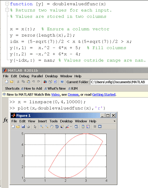

AtlasSniperma
ummm, silly question I suppose(and one with likely no answer), and I don't know which Maths subforum to put it in. It's not a pressing thing, just a curiosity.
How do I find the equation of a section that is the overlap of two functions? Not the area of such a section(which would be using Integral), but the equation for it.
e.g I have two functions
y=x^2-4x+5
y=-x^2+6x-4
Now I can tell a program to draw this overlap using
y=[x^2-4x+5,-x^2+6x-4]{(5-sqrt(7))/2<x<(5+sqrt(7))/2}
But I would much rather have an equation proper.
Is this at all possible?

By "overlap" I assume you mean the bounded region in the plane that lies above the graph of ##y = x^2 - 4x + 5## and below the graph of ##y = -x^2 + 6x - 4##.
There is no equation that represents this region, but if you project this region onto the x-axis, you can represent this interval by an inequality.
For the two equations you gave, both of whose graphs are parabolas, the bounded region is such that ## -x^2 + 6x - 4 \ge x^2 - 4x + 5##. You can use algebraic techniques to rewrite this as a quadratic inequality, and eventually as in equality of the form ##A \le x \le B##.

So you're saying that it's not possible? Even with the use of complex Numbers or some such?
Yes, you can write a program to do that. The thing you would have to clear up is when you say "or" in your examples.
For example, you say: f(1.5)=1.25 or 2.75
Does this mean the program should return either 1.25 or 2.75 randomly? Like one time you call the function and it returns 1.25 and the next time it might say 2.75?

I already told you this could be done easily. If you answer the question I asked, I can give you a simple code that will do it...
Sure, I apologise, i mean to return both values at once :D
No worries. It is easy to do what you want with a computer. Here is an example I made in MATLAB. I have shown the code which produces the values, how it is called and a plot made from the function.

The perimeter of a region of overlap consists of an infinite number of points. See the graph that mfig posted, labeled Fig 1. The curve that makes up the upper boundary consists of an infinite number of points. The curve that makes up the lower boundary also consists of an infinite number of points. An equation doesn't return values other than true or false. The equation is "true" some pair of numbers (x, y) makes it a true statement.
In the MATLAB code that mfig posted, he's setting idx to an inequality of the form ##A \le x \le B## (in his code values for A and B are stated, and the inequality takes the form ##A < x \text{ and } B > x##, with A and B the constants he wrote). His version and mine are equivalent -- we're saying the same thing.
I said this twice before, so this makes the third time. To find the region of overlap, you need an inequality, which gives you the interval. For each x value in this interval, the graph of one of the functions lies above the graph of the other, so the two graphs form the upper and lower boundaries for a close region. Outside that interval the graphs don't overlap, at least in the sense that they enclose a bounded region.

The MATLAB code that mfig showed calculates two function values for each x value within the interval: ##f_1() = x^2 - 4x + 5## and ##f_2(x) = -x^2 + 6x - 4##. His code calculates the two function values at x values in the interval ##\frac{5 - \sqrt{7}}{2} < x < \frac{5 + \sqrt{7}}{2}##, an interval that he had to use algebra to get.
mfig's MATLAB code calculated a bunch of points on each graph, above this interval, and graphed them to get Fig 1.
In answer to the question you asked in the first post, there is no equation that represents the two-dimensional bounded region where the two parabolas overlap.
