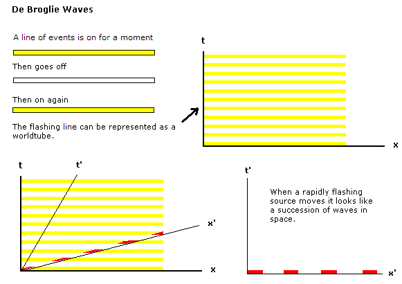

Aziza said:
However, when the velocity is zero, the denominator of the wavelength equation becomes infinite...by infinite wavelength I am guessing this means that the wavelength is so long that it actually doesn't exist? So does that mean that a piece of matter only create a wave when it is moving? But that can't be right since motion is relative, so if something is not moving with respect to me, it is moving with respect to someone else, so that other person would be able to detect a matter wave but I wouldn't be able to...??
De Broglie started with an "internal frequency" in the rest frame which has the same phase everywhere (infinite phase velocity). When such a frequency is Lorentz-transformed into moving frames, relativity of simultaneity means that the phase in the new frame must vary spatially as well as temporally, ie it looks like a wave with finite wavelength. It's the same waveform in spacetime, but it's sliced at an angle instead of parallel to the wavefronts.
The diagrams here are a good start for how to visualize the Lorentz-transformation:
http://en.wikibooks.org/wiki/Specia...ation_and_length_contraction#De_Broglie_waves
