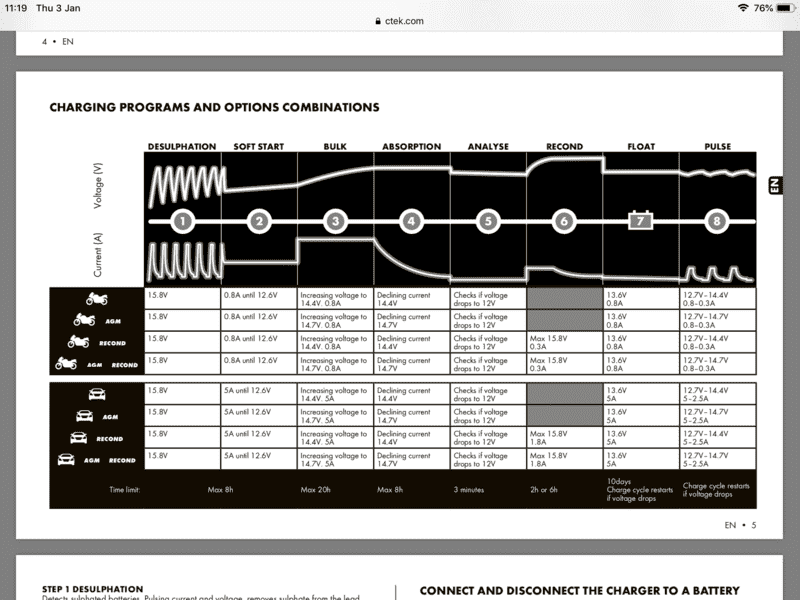

These people have done all the hard work for you:
https://www.ctek.com/products/vehicle/mxs-5-0
This device has a “recondition” mode that boils the electrolyte in a controlled manner to eliminate stratification. It also pulses AC to desulphate the plates somewhat. All in a relatively cheap package that is safe and CE marked. It can be left unattended and will trickle charge indefinitely to maintain a battery.
I have one of these, and it managed to recover a failing, 16 year-old 120 Ah battery, which went on for another four years. Highly recommended.
Edit: I’m not sure if the desulphation is AC or just pulsed DC. Seems to work, anyway.

Doesn't look like it boils the electrolyte in much of a controlled manner. It just applies 15.8 V. No temperature feedback.

As I say, these people have done all the hard work for you (see graphs below). Now, you could run the programmes below with a bench power supply, but pressing a button and letting a microcontroller do the work is a lot easier.
Regarding ‘boiling’ - this is a loose term referring to the off-gassing of hydrogen, oxygen, hydrogen sulphide and others when a battery is being charged, especially with an elevated voltage. It doesn’t mean heating the electrolyte to boiling point in this context. You’ll hear and sometimes see, if the battery has a clear case, bubbles fizzing up from the plates. If the vent(s) block, the battery can overpressure and burst, showering you with acid. The H and O are produced at an ideal ratio for explosive combustion. Any spark could trigger what is effectively an acid bomb.
Edit: Another advantage to the Ctek unit is that the leads are dead until a battery is detected, reducing the chance of a spark. Reverse polarity is also protected against.
It also senses battery temperature, thus providing closed loop protection against overheating.
