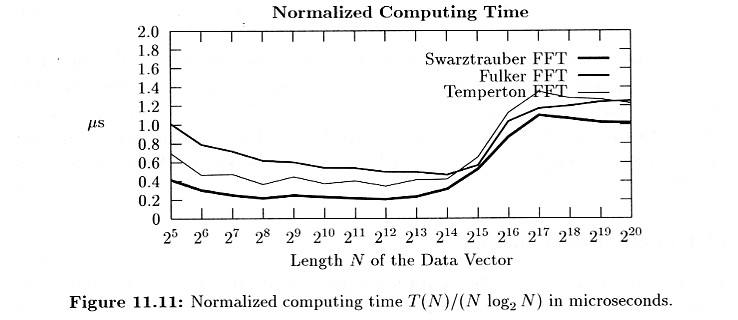

To bring things back on track, here is a figure from C. W. Ueberhuber, Numerical Computation: Methods, Software, and Analysis (Springer, Berlin, 1997):
There is significant increase in computing time when the data no longer fit in the cache.
