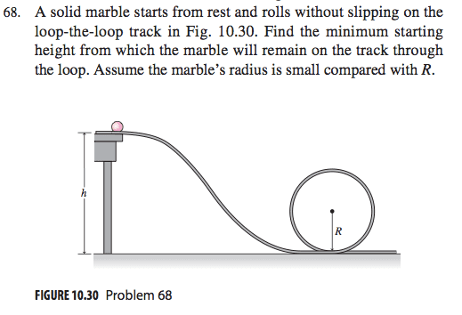

A solid marble starts from rest and rolls without slipping on the loop-the-loop track in Fig. 10.30. Find the minimum starting height from which the marble will remain on the track through the loop. Assume the marble’s radius is small compared with R.
Physics diagram of a marble released from rest at height h on a curved track that drops into a vertical loop of radius R sitting on a horizontal floor; the loop's radius is labeled R. Caption reads FIGURE 10.30 Problem 68.

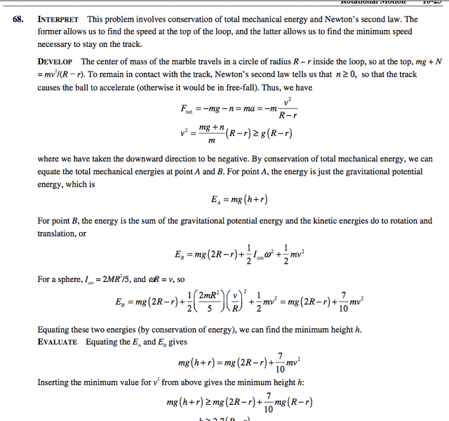

Solution:
Textbook solution page for a loop-the-loop problem (problem 68) with interpretation, development and evaluation steps, showing energy conservation equations for points A and B, and the minimum height h derivation.
In the question, why is the radius of the circle referred to as R-r instead of just R? Is this common notation since I'm having a little bit of trouble understanding what exactly r is in this case and how this form helps us assess the situation. Also, why must v >= g (R-r)? I think this question stems from my previous one, but if the forces at the top must be at least Fn + mg, why isn't v >= (gr)0.5 since then v2/r >= g at the top for there to be a normal force still, correct?

##r## is the radius of the ball, so the distance from the center of the loop-de-loop to the center of mass of the ball is just the full radius of the loop, ##R##, minus the distance the center of mass of the ball is raised up from the edge of the loop, ##r##. Make sense? And so the equation they arrive at for the minimum velocity, ##v^2 \geq \sqrt{g(R - r)}##, matches what you have, provided that you use ##R - r##.

Haha okay, wow that does make sense. They stated in the question r is small compared to R so I thought we did not consider it. Thanks for the clarification!
Yeah, sure thing! Actually, given that they said the radius of the ball is small, I would actually be very confused too if I hadn't been working backwards from the solution, so I don't blame you at all.
