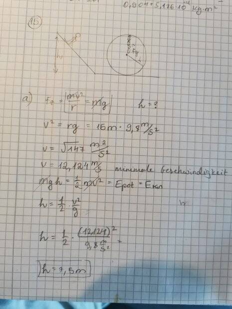

A skier with mass m=70 kg stands on a ramp of height h. At the foot of the ramp, there is a loop with a radius of r=15 m. When entering the ramp, the speed is v1=0 m/s.
a) For test purposes, the skier is also held in the loop by a rail system so that he cannot fall off if his speed is too low. How high does the ramp have to be at least so that he can get through the loop in this case? Here I considered the loop as a hill that he needs to get through so I got that ramp should be 30m, since the radius is 30m.
b) Normal operation of the loop takes place without a safety rail system. In this case, how high does the ramp have to be so that the skier can get through the loop without falling off? Here I thought that the force of gravity must be equal to the centripetal force. So I got that h is 7.5, that means half of the r.
I can't understand what difference that makes if the person is held by a rail system or not. I tried to solve it in 2 ways considering the potential and kinetic energy, so I'm not sure that my answer is correct. It would be really helpful is someone could say that what I thought makes sense.

Right idea, suggesting that you have understood the difference between the two cases, but you somehow arrived at a lower number. Did you get confused between the velocity at the bottom of the loop and the velocity at the top?

Hey, thanks for reaponding. I just assumed that the calculation should be different if they asked 2 different things..
Handwritten physics solution on squared paper: a loop-the-loop diagram with radius r and a ramp of height h, and part a) deriving minimum speed v = sqrt(rg) = 12.124 m/s and height h = 1/2 · v²/g = 7.5 m.
I didn't consider the velocity at the bottom, but the minimal velocity. If I understood correctly..

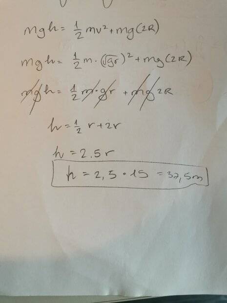

Oh sorry I will post my way now. Let me know if images are fine or maybe I should write the equations here aswell. And That was my third assumption:

That looks fine. Did you forget to add the 2r in post #1?
Wrt images, they should really only be used for diagrams and textbook extracts, but your writing is quite clear and your working is organised.
PainlessPeach said:
Let me know if images are fine or maybe I should write the equations here as well.
You should write the equations, using ## \LaTeX ##, see https://www.physicsforums.com/help/latexhelp/. That way people trying to help you can choose "Reply" and edit what you have posted. It also avoids confusion (is that a "2" or a "7" in your final answer)?
In your first post you gave the answer to (b) as 7.5m but now you have reached 37.5m, which is correct. Did you forget the ## mg(2r) ## term first time round?

thanks for your reply, yes I tried to calculate it again with the ## mg(2r) ## term and got 37.5 m. This refers to (b) when the skier has no securing system. But I'm still not sure about how to solve (a) considering the rail.
