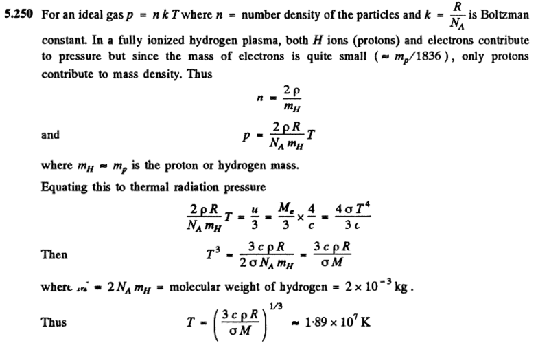

Find the temperature of totally ionized hydrogen plasma
of density p = 0.10 g/cm^ at which the thermal radiation pressure
is equal to the gas kinetic pressure of the particles of plasma. Take
into account that the thermal radiation pressure p = u/3, where u
is the space density of radiation energy, and at high temperatures all
substances obey the equation of state of an ideal gas.
The image above is the solution posted by the book. I can follow the reasoning that has been used, but i have a trouble particularly at the first equation itself.
Why should $$n = 2 \rho / m_{H} $$ instead of $$n = \rho / (2m_{H})$$, since the mass os a molecule of hydrogen is two times the hydrogen/proton mass?
If you had only protons there, the mass would be the same, and the density would be the same. From ##n=\rho / m_H## you'd get a number of protons. Now, since you know there is an extra particle for each proton that doesn't really do anything mass-wise, you get twice the number of particles that the same density/mass consideration would suggest. Unsurprisingly, ##n_{proton+electron}=2n_{proton}##.
The equation you think should be there instead suggests that you should only count half as many particles as what you get from density/mass considerations.
You could imagine some fantasy physics where each proton is accompanied by not only an electron, but also an additional imaginary particle that doesn't do anything mass-wise. The number of particles ##n## in that case should then be 3 times what you get from density/mass. Which would be ##n=3\rho / m_H##
The number of hydrogen molecules (each of mass ##2m_H##) per unit volume is ##\frac {\rho}{2m_H}##.
One hydrogen molecule, when fully ionised, produces 4 particles (2 protons and 2 electrons).
So, after ionisation, the number of particles per unit volume is ##4 \times \frac {\rho}{2m_H} = \frac {2\rho}{m_H}##.
