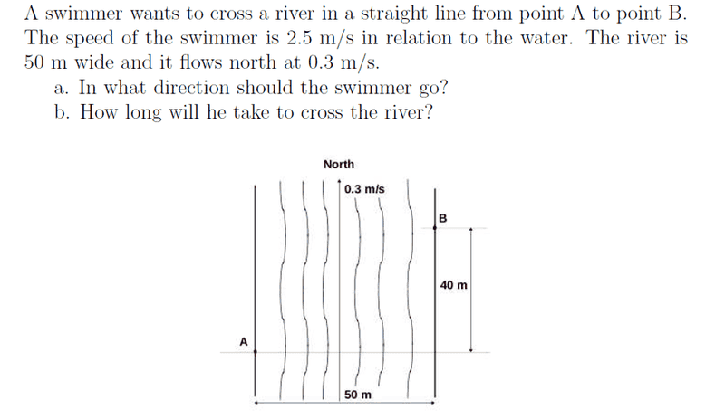

What direction should the swimmer swim in this problem?

Here is the problem.
Va/b = Va - Vb
s - swimmer
w - water
Vw = 0.3m/s
Vs/w = 2.5m/s
therefore, Vs - Vw = 2.5m/s
Vs - 0.3m/s = 2.5m/s
Vs = 2.8m/s
Now I am a bit confused at this point. It is asking which direction the swimmer needs to swim. What I have tried to do is draw 1 velocity vector pointing directly upward (the 0.3m/s one) and another pointing 38.66 degrees from the horizontal (I calculated that angle using the dimensions given). Am I on the right course to solving the problem, or am I completely wrong?
Hi Oblivion77! :smile:
Vs = 2.8m/s
Nooo …you can't say 2.5 + 0.3 = 2.8 …
relative velocities are vectors, so they add (and subtract) like vectors.
… What I have tried to do is draw 1 velocity vector pointing directly upward (the 0.3m/s one) and another pointing 38.66 degrees from the horizontal (I calculated that angle using the dimensions given). Am I on the right course to solving the problem, or am I completely wrong?
Yes that's fine so far …
now complete the vector triangle …
you know the length and direction of one side, the angle of another side, and the length of the third side …
from that, you should be able to find the other angle(s). :smile:

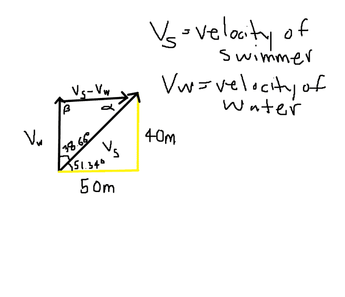

Thanks for the response. I was wondering If I have this diagram right?
If it's correct would I just then need to solve for the angles? Sorry the drawing isn't really to scale.
HI Oblivion77! :smile:
(just got up … :zzz:)
Yes, the diagram is fine (and the arrows are the right way) …
so you know that Vs has length 0.3, and Vw - Vs has length 2.5, and you know one of the angles …
now use the sine rule and the cosine rule. :smile:
Thanks for the response, doesn't Vw have a length of 0.3 and Vs - Vw = 2.5?
oops!
oops! yes, I got them the wrong way round. :redface:
No problem, thanks for the help.
