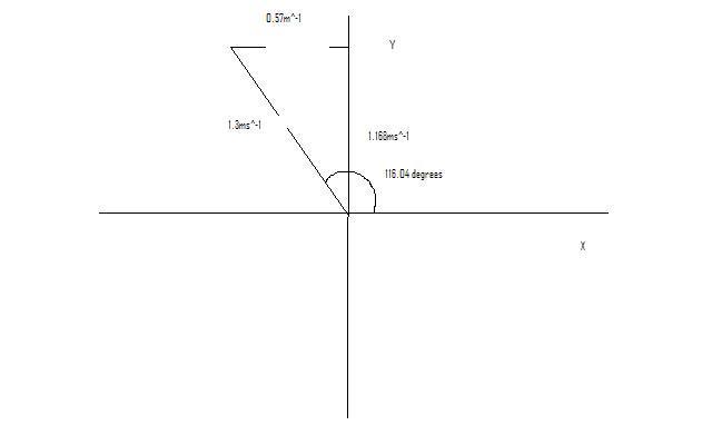

You wish to row straight across a 63m wide river. You can row at a steady 1.3 m/s relative to the water, and the river flows at 5.7 m/s. In what direction should you head? How long will it take you to cross the river?
Is the answer right? Could the answer equally be 26°?
Think about this with simple logic for a minute. The river is flowing downstream at some speed. In order to not be at all swept downstream, the upstream component of your rowing speed relative to the river has to exactly match the downstream speed of the river. Is that possible in this problem?

I suppose the answer is 116° instead of 64°.

I've already answered it. In rowing at 116° from the x-axis, the boat goes against the current, no?
I tried solving it from another approach, where;
(1.3ms^-1)^2 = (0.57ms^-1)^2 +y^2
y = 1.168ms^-1
theta = 26°

There's a typo in the OP. If you look at the attachment you'll see the river speed is given as 0.57 m/s.
Yes, negation, the answer is 26 degrees to the normal.
Ah ... well that explains it.

My mistake for the typo. I apologize.
Would that be the same as 116 degrees from the x-axis since it would in other words implies 26 degrees NW.

Since the OP says nothing about x or y axes, nor about compass directions, that's impossible to answer.
In terms of river bank and direction of flow of river, where were you measuring 116 degrees from?

I measured 116° from the x-axis.
That would put the boat in quadrant 2 but of course since there was no reference point mentioned by the question, it could equally be implied 26° NW, 64° from the x-axis or 26° NE, isn't it?
I have a preference for 116° from the x-axis to do away with all the bearings.

I cannot see inside your head. I do not know where your x-axis is, nor which way the river runs in terms of a compass bearing.
