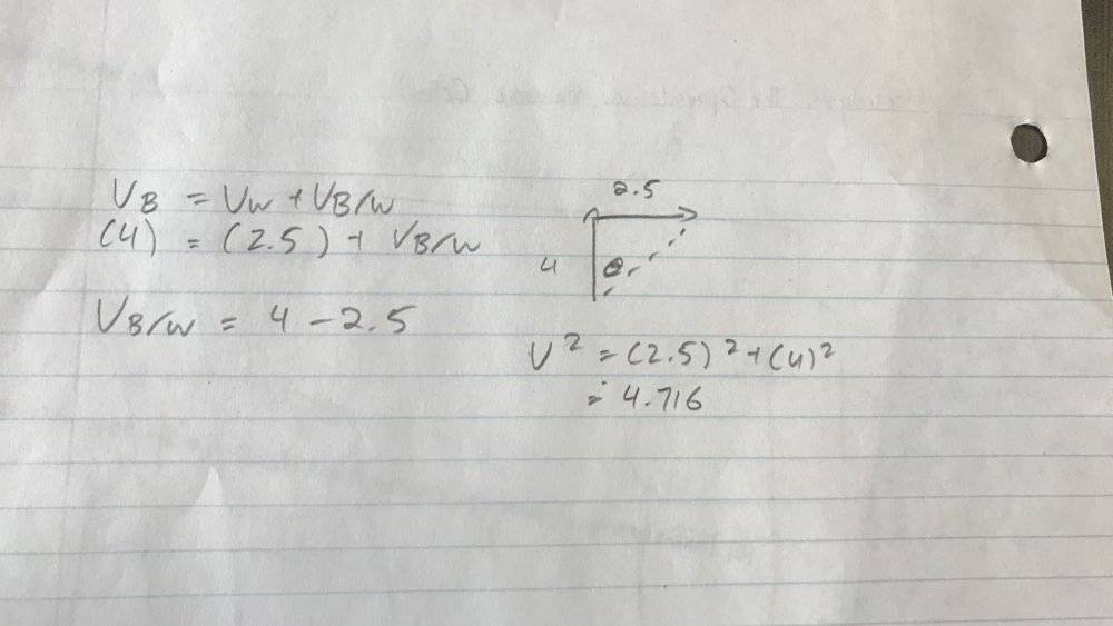

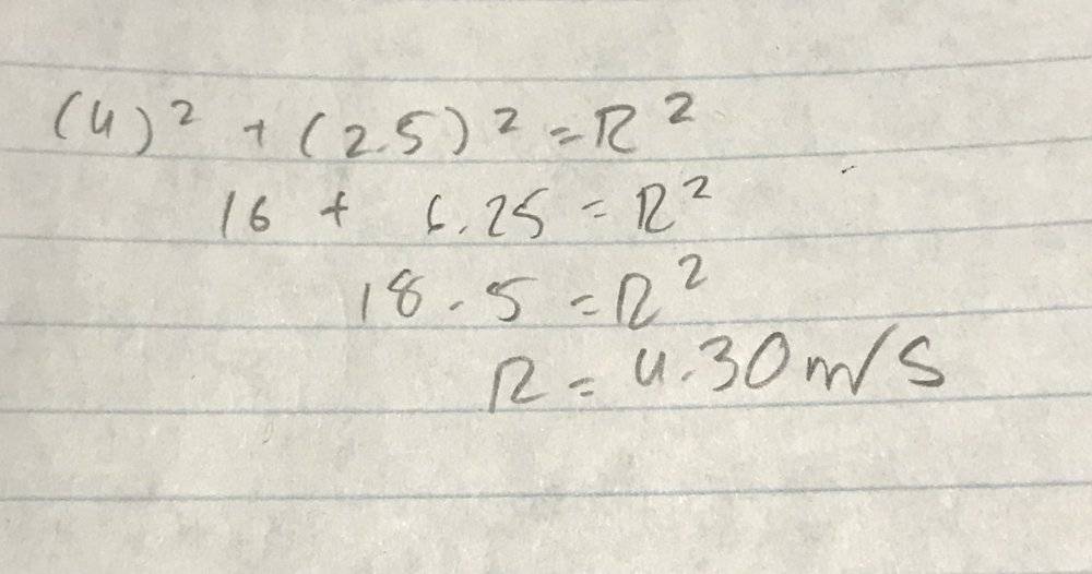

Will I be using Pythagorean's formula?
Use it, post it and explain what you think it means.
I'm not sure if this is right.. if it is, I am thinking of a way to calculate the direction.
Why does this give you the answer you are looking for? Remember the idea is that Bob reaches a point directly across. How is that figured in your equation? Look at part (b). Must Bob aim himself straight across in order to get to a point straight across?

If I'm drawing a triangle, the hypotenuse would be B/W, right? I think that the adjacent side would be Bob and the opposite side would be the water.
One way to think about this is to consider the two motions separately: Bob swimming in the water; and the water moving. Imagine Bob swims for ##1s##, like a dolphin(!), and moves ##4m##. Then, imagine the water moves for ##1s##: that's ##2.5m##. When you put these two together that's where Bob ends up, after ##1s##.
That's one way to explain why he can't just aim directly across at the opposite bank. He would swim ##4m## across and then the water would take him ##2.5## downstream, and he wouldn't be going in the direction he wants towards the opposite bank.
Is B/W the hypoteneuse? Is it necessarily a right-angle triangle?

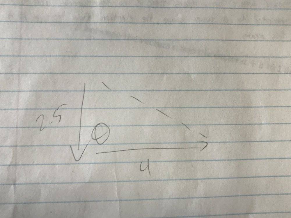

Is the answer above correct...?
ttpp1124 said:
That shows what would happen if Bob aimed directly across at the opposite bank and got taken downstream with the river. That's not what you (or Bob) wants!
Is this better?
ttpp1124 said:
Is this better?
That's the same drawing turned upside down.
You want the sum of the river velocity and the swimmer velocity to give a result that points directly across the river. Can you draw a right triangle to show that?
The flow velocity and the desired velocity are at right angles. If those are two of the sides of the triangle, it will indeed be a right triangle.

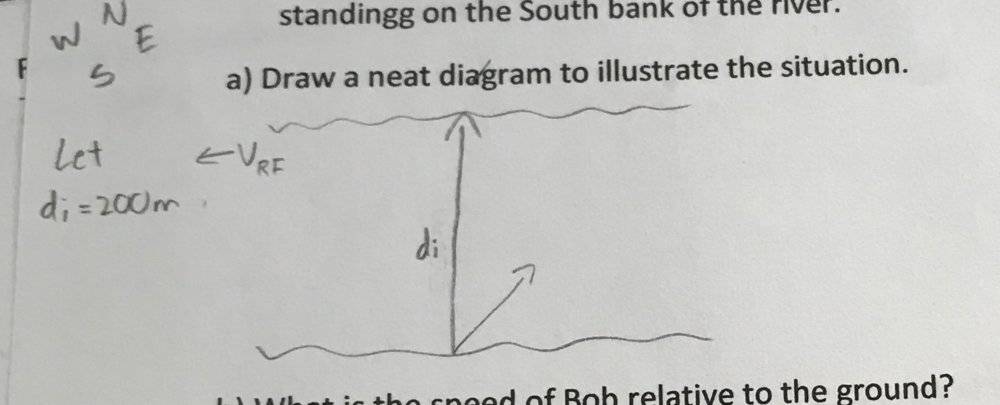

As @jbriggs444 pointed out, it's the river's velocity and Bob's resultant velocity that you know are at right angles. Bob can swim at angle any relative to the river.

I drew another diagram, I'm not sure if I'm on the right track..
