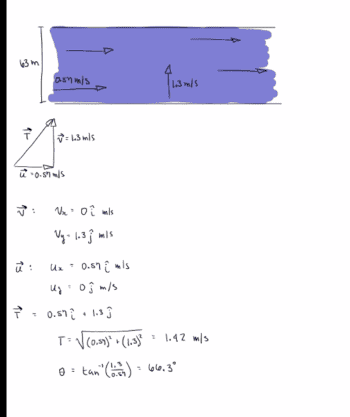

You wish to row straight across a 63 meter-wide river. You can row at a steady 1.3 m/s relative to the water and the river flows at 0.57 m/s.
In what direction should you head, and how long would it take you to cross the river?
I've attached an image to show my drawing of the situation.
What I have done is make 3 vectors.
##\vec v## represents the boat's vector and it's unit notation is ##\vec v = (0\hat i + 1.3\hat j)##
##\vec u## represents the current of the river with ##\vec u =(0.57 \hat i + 0\hat j)##
##\vec T## represents the sum vector and I get ##\vec T =(0.57 \hat i + 1.3\hat j)## ##=(1.42~m/s,66.3°)##
Now I'm not sure where to go after this. I know the current will be pushing the boat in a manner that causes it to not be perpendicular to the shore and I need to find and angle to aim the boat so that it can get straight across.
The problem mentions the term "relative" so I kind of think of reference frames, but I'm not sure how to go about using such a thing here.

With that ##\vec v## you are getting a resultant velocity that has a component in the river direction and therefore you are not crossing straight over the river (you will end up downstream) as specified by the problem.

So then I need to find a way to have ##\vec T## to have a horizontal component of 0?

Aren't the two missing quantities you mention what I have found for ##\vec T##? It's direction and magnitude? This would give me 6 total properties as you've mentioned.
But your vector ##\vec T## points in the wrong direction, if I didn't misunderstand your notation the angle should be ##90^o##, not ##66.3^o##.
Looks like I misunderstood how to set this up. I had my original vector pointed straight across because it's the shortest distance. But I need the sum vector to be straight across after I've started swimming against the current. Let me rework some of this.

Ok I think I've got it worked out. I had to find what was needed to get the sum vector to be perpendicular and got a 26 degree upstream angle and will cross in 54.3 s!
That looks pretty good, I've only obtained a small difference in the crossing time - I calculated 53.9 s. If in your opinion your answer is accurate enough, well done. Otherwise we could compare results, if you want to.
Looks like you are correct. I made the mistake of carrying a rounded solution through my work. In one go on the calculator, I've got 53.92.
