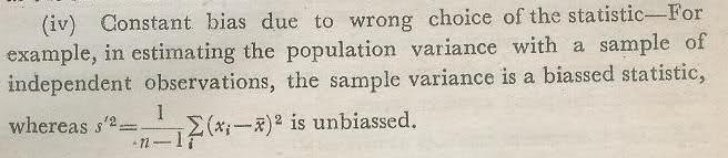

In the first step of stating the descriptive measures of dispersion all the textbooks, as I have gone through
( ex: attachment -1), use a single and unique "standard deviation formula" (and no context dependent definition). And this is done much before coming to the chapters of "point estimation" or "sample survey" (where we start talking about "expectation/unbiasedness" or "population/sample".
Then again, as learned from textbooks( attachment-2), the sample variance (also) have divisor
n, not n-1). Hence it is stated, sample variance is not unbiased estimator of population variance.
attachment -1
attachment-2
The standard deviation with the divisor of n is the MLE when the Gaussian model is assumed and both [tex]\mu[/tex] and [/tex] \sigma [/tex] are unknown. (It is a function of the variance, the MLE of [tex]\sigma ^2[/tex], so is the MLE of the standard deviation. The sample variance with the divisor of n -1 comes from the unbiased estimator of variance.
But: this expression
[tex] \frac 1 n \sum_{i=1}^n (x_i-\bar x)^2,[/tex]
are also given as formulas for population variance and sample variance, respectively, for discrete populations, since in this case the population mean is defined as
[tex] \mu = \sum 1 n \sum_{i=1}^n[/tex]
and so is identical in form to the arithmetic mean.
So, when you use the variance with n in the denominator, you must be clear whether you are dealing with a sample or population: the interpretation differs. That is the context.
