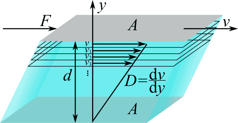

What does 'dv and dx' mean in f = eta A (dv/dx) in coefficient of viscosity?
2. Homework Equations
As I know v = velocity and x = distance. then what does 'dv' and 'dx' express here. Kindly explain.

Here's what Wikipedia has to say about it: https://de.wikipedia.org/wiki/Viskosität (They used ##y## instead of ##x##.)
In the experiment, it can be shown that, ideally, the force ##F## necessary to move the top plate is proportional to the area ##A##, the speed difference ##\Delta v## and antiproportional to the spacing of the plates ##\Delta y##, that is:
##F \sim A## and ##F \sim \Delta v## and ##F \sim \dfrac{1}{\Delta y}##
This gives the equation ##F = \eta A {\dfrac{\Delta v}{\Delta y}}## and as continuous, infinitesimal form ##F = \eta A {\dfrac{d v}{d y}}##.

I agree with @fresh_42 . This equation is typically used to introduce Newton's law of viscosity, based on the most simple example. In this example, you have a fluid contained between 2 large parallel plates, with the lower plate (y=0) stationary and the upper plate y=h) moving at velocity V in the positive x-direction. The fluid x-velocity in the region between the plates is linear, and given by:$$v_x=V\frac{y}{h}$$. The force in the positive x-direction required to cause the fluid to shear with this velocity profile is given by Newton's law of viscosity as:
$$F=\eta A\frac{dv_x}{dy}=\eta A\frac{V}{h}$$where ##\eta## is the fluid viscosity and A is the plate area. The derivative of the x-velocity with respect to y is referred to as the "shear rate."
The example given by Buzz Bloom, rather than involving shear of the fluid, is referred to as an elongational deformation. In this case, dv/dx is called the "rate of elongation", and the tensile force involves 3 times the viscosity.
