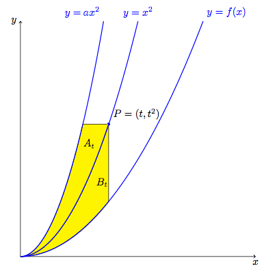

Let $f(x)$ be an unknown function defined on $[0,\infty)$ with $f(0)=0$ and $f(x)\le x^2$ for all $x$. For each $0\le t$, let $A_t$ be the area of the region bounded by $y=x^2$, $y=ax^2$ (where $1<a$) and $y=t^2$. Let $B_t$ be the area of the region bounded by $y=x^2$, $y=f(x)$ and $x=t$. See the image below:
a) Show that if $A_t=B_t$ for some time $t$, then:
$$\int_0^{t^2}\sqrt{y}-\sqrt{\frac{y}{a}}\,dy=\int_0^t x^2-f(x)\,dx$$
b) Suppose $A_t=B_t$ for all $0\le t$. Find $f(x)$.
c) What is the largest value that $a$ can have so that $0\le f(x)$ for all $x$?
My solution:
Part(b):
Since I have no idea how to prove the part a of the problem, I'd like to borrow here from the given expression in part a so that I could use it to solve for $f(x)$.
$$\int_0^{t^2}\left(\sqrt{y}-\sqrt{\frac{y}{a}} \right)\,dy=\int_0^t (x^2-f(x))\,dx$$
$$\left[\frac{2y^{\frac{3}{2}}}{3}-\frac{2y^{\frac{3}{2}}}{3\sqrt{a}} \right]_0^{t^2}=\left[ \frac{x^3}{3} \right]_0^{t}-\int_0^t f(x)\,dx$$
$$\int_0^t f(x)\,dx=\left[ \frac{x^3}{3} \right]_0^{t}-\left[\frac{2y^{\frac{3}{2}}}{3}-\frac{2y^{\frac{3}{2}}}{3\sqrt{a}} \right]_0^{t^2}$$
$$\int_0^t f(x)\,dx=\frac{t^3}{3} -\frac{2t^3}{3}+\frac{2t^3}{3\sqrt{a}} $$
$$\int_0^t f(x)\,dx=\frac{2t^3}{3\sqrt{a}}-\frac{t^3}{3} $$
Now, if we integrate a function $f$ and then differentiate the integral with respect to its upper endpoint ($t$ as in our case) we get $f$ back again.
$$\frac{d}{dt} \int_0^t f(x)\,dx=f(t)$$
which means
$$\frac{d}{dt} \int_0^t f(x)\,dx=\frac{d \left(\frac{2t^3}{3\sqrt{a}}-\frac{t^3}{3} \right)}{dt} $$
$$f(t)=\frac{d \left(\frac{2t^3}{3\sqrt{a}}-\frac{t^3}{3} \right)}{dt}$$
$$f(t)=\frac{2t^2}{\sqrt{a}}-t^2 $$
and hence $$f(x)=\frac{2x^2}{\sqrt{a}}-x^2 $$
Part (c):
We're told that $f(x) \ge 0$, so we have
$$\frac{2x^2}{\sqrt{a}}-x^2 \ge 0$$
$$x^2\left(\frac{2}{\sqrt{a}}-1 \right)\ge 0$$
and since $x^2 \ge 0$ for all real $x$, the inequality becomes
$$\frac{2}{\sqrt{a}}-1\ge 0$$
$$\frac{2}{\sqrt{a}}\ge 1$$
$$\sqrt{a}\ge 2$$ and therefore $$a \ge 4$$.
The largest value that a can have so that $f(x) \ge 0$ is hence 4.
Great job with parts b) and c), anemone! (Sun)
Here is my solution:
a) We may take the $y$-coordinate of point $P$, and using the point on the curve $y=ax^2$ having the same $y$-coordinate, state:
$$ax^2=t^2$$
Taking the positive root, we have:
$$x=\frac{t}{\sqrt{a}}$$
And so integrating with respect to $y$, we have:
$$A_t=\int_0^{t^2}\sqrt{y}-\sqrt{\frac{y}{a}}\,dy$$
Now, integrating with respect to $x$, we see we may state:
$$B_t=\int_0^t x^2-f(x)\,dx$$
So, if $A_t=B_t$, then we may state:
Here's another slightly different approach:
If we add a horizontal strip to $A_t$, we find the area of this strip is:
$$dA_t=\left(t-\frac{t}{\sqrt{a}} \right)\,dy$$
And adding a vertical strip to $B_t$, we find the area of this strip to be:
$$dB_t=\left(x^2-f(x) \right)\,dx$$
We require these differentials to be the same, hence:
$$\left(t-\frac{t}{\sqrt{a}} \right)\,dy=\left(x^2-f(x) \right)\,dx$$
On the left, we need to express $t$ as a function of $y$, and we know:
$$y=t^2\,\therefore\,t=\sqrt{y}$$
and so we have:
$$\left(\sqrt{y}-\sqrt{\frac{y}{a}} \right)\,dy=\left(x^2-f(x) \right)\,dx$$
Now is is a simple matter of adding all of the elements of the areas, to get:
b) Now, using the results of part a), differentiating with respect to $t$, we find:
$$\frac{d}{dt}\int_0^{t^2}\sqrt{y}-\sqrt{\frac{y}{a}}\,dy=\frac{d}{dt}\int_0^t x^2-f(x)\,dx$$
$$\left(t-\frac{t}{\sqrt{a}} \right)2t=t^2-f(t)$$
Solving for $f(t)$, we find:
$$f(t)=\left(\frac{2-\sqrt{a}}{\sqrt{a}} \right)t^2$$
Hence:
$$f(x)=\left(\frac{2-\sqrt{a}}{\sqrt{a}} \right)x^2$$
c) In order for $f(x)$ to be non-negative, we require the coefficient of $x^2$ to be non-negative:
$$\frac{2-\sqrt{a}}{\sqrt{a}}\ge0$$
$$2\ge\sqrt{a}$$
$$4\ge a$$
