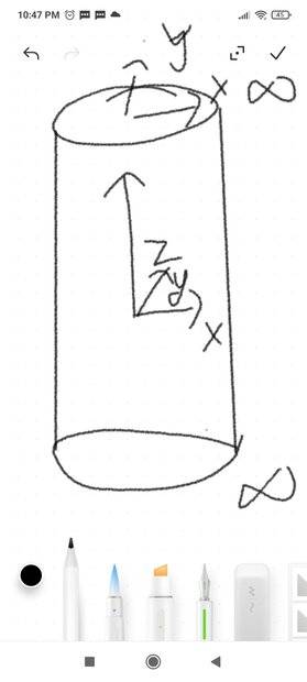

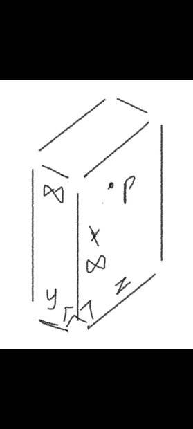

Q1) Why did he make the cylinder's height infinite and the thick slab's plane infinite...?
Q2)I dont understand what he meant by them having dimensional symmetry...symmetry of what? electric fields? and how did he get that it will 1, 2 or 3..Can someone explain this...?
Context below..

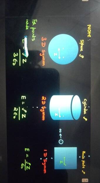

A teacher whose video lessons i follow then gave us the expressions for the field at a point inside a cylinder whose height is infinite but cross sectional area is finite
$$ \frac{ \rho z } {2 \epsilon} $$
Where z is the distance from the line of symmetry ..

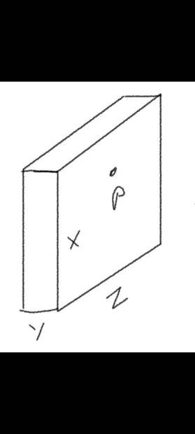

and the field at a point inside a thick slab whose length and thickness is infinite but breadth is finite...
$$ \frac{ \rho z } { \epsilon} $$
Where z is the distance from a plane of symmetry..
He then went on to explain that the sphere has 3d symmetry the cylinder has 2d symmetry and the slabs have 1d symmetry..and thats a way to remember these results...
So that there is only parameter in each case.

He means geometric symmetry of the object, but I cannot see a basis for that categorisation.
The sphere does have more symmetry than the other two since you can swap all the axes around, but I would not have thought the infinite cylinder had any more symmetry than an infinite slab. In both cases you can swap two axes.
It may be a reference to dimensionality of Lie groups, in which case I defer to anyone with some familiarity with those.
Suppose the slab is very large but finite. For a given value of z, the field’s magnitude and direction will also depends on where you are (x,y) in the slab.
For example, the field near an edge or corner will be very different to the field near the centre, even for the same z.
That’s because the field at any point is the (vector) sum of the fields from all surrounding charges. The distribution of surrounding charges is very different for a point near the centre compared to a point near an edge or corner.
But if the slab is infinite, there are no corners or edges. You can travel in any (xy) direction and the distribution of charges around you never changes. So the field depends only on z.
As a result, the field can have no components in the x and y directions. The field acts only in the z direction and this makes its calculation simple (e.g. using Gauss’s law).
You should be able to apply a similar argument to the cylinder for yourself.

Don't like the terminology. Better to use the terms spherical symmetry, cylindrical symmetry and planar symmetry; these terms describe the charge distributions in your 3 cases.

This is an unhelpful reference. It does not allow us to look at what you have seen, which is crucial to see what it actually says rather than your recollection of it.
I quoted him word to word...

So that just means if I integrate the small de fields acting on a point inside the slab (not on the surfaces) throughout the whole volume...id get only the z component as the net field... The x and the y components would be same on either side of this point... Hence they would cancel out?
It means more than that. There are no x and y components. That's what
kuruman said:
From this it follows that the electric field can only be in a direction perpendicular to the plane.
means. The x and y components are zero.

Sorry, but that is not good enough. If I had a penny for every instance of a user claiming to quote a source word by word just for it to turn out this was certainly not the case … I would not be rich, but I would have a lot of pennies …
Please do not quote. Give the actual reference.

But its a video in an app Which doesnt allow screenshots or screen recordings...I could use another device to take a snapshot hmm uploading now..

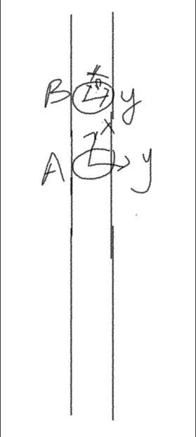

But if I take an individual element in the slab and use that to find a small de field at a point x and y component wont be zero right... The total sum of the x component and the total sum of the y component would be zero respectively... I think

Please check I have edited.... The little white mark is because my number was visible...learnt it the hard way that people on physics forums could also be concerned with prank calling numbers 😔

That would be the case. The idea is to use symmetry to deduce that the integrals and hence the components are zero without actually having to integrate.

This applies to a point inside as well as outside the slab?

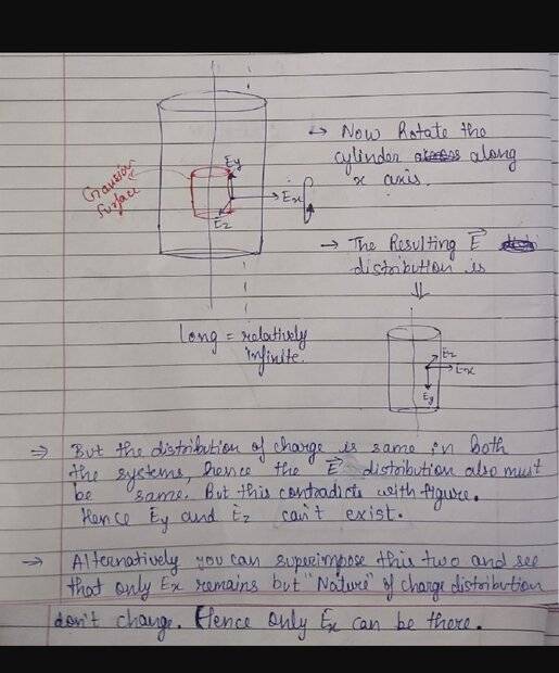

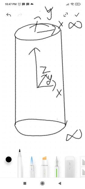

Also for the cylinder case... Since the z axis is infinitely long considering the height is along the z axis... The x and y axis are on the cross sectional area of the cylinder... Any point inside the cylinder's net field would only be in the x and y direction?
Net field could only be calculated in the Same plane then? For example I could not get any field from A on plane B which contains point P...

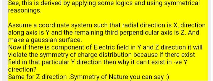

I think i get it.....Can you tell me how the cylinder case can also be viewed...how do I rotate the cylinder about the z axis ...?

If its symmetrical about an axis then that is Not a solution?

I see... In the case of cylinders there's this simplification which most standard textbooks use and they assume the charge of the cylinder to lie on an infinitely long rod...how do they get that?

Also for the case of the cylinder equations appear to be symmetrical only about the axis of height...the plane in cross sectional area is where the direction of Electric field Should be ...

I don't understand your question.
If a charge distribution has a certain symmetry then the field must have that symmetry.
The sphere has spherical symmetry, meaning that it can be rotated around its centre in any direction.
The infinite cylinder can be rotated through any angle about its axis, translated to any displacement along its axis ("glide" symmetry) or reflected about any plane normal to its axis or any plane through the axis.
The infinite slab can be rotated to any extent about any axis normal it, translated to any extent in any direction parallel to it, or reflected about any plane normal to it or the plane parallel to it through its centre.
I think that is everything.

Yes I got that, the z axis is the cylinder's axis, the y axis is one of the two axes in the cross section of the cylinder...
The above image is the reference axes I took. In the image below the person has taken the cylinder's axis as y axis and the axis whose field im confused about as z axis.
This is an argument I received for why there's no field along the z axis (in this person's diagram)however I dont understand how its symmetrical there
As you say the field is everywhere normal to the cylinder's axis I agree with that but he says otherwise .
Yes I got that, the z axis is the cylinder's axis, the y axis is one of the two axes in the cross section of the cylinder... View attachment 345757
This is an argument I received for why there's no field along the z axis (in this person's diagram)however I dont understand how its symmetrical thereView attachment 345758
As you say the field is everywhere normal to the cylinder's axis I agree with that but he says otherwise .View attachment 345759
I mean, it is not very clearly argued. The actual argument is to consider the reflection symmetry in a plane through the central axis and the point you are considering the field at. Since the electric field is a proper vector, the component orthogonal to the reflection plane changes sign under the reflection. However, the charge distribution is the same before and after the reflection and therefore the field must also be the same. The component in the y-direction must therefore equal its own negative, which can only happen if it is zero.
