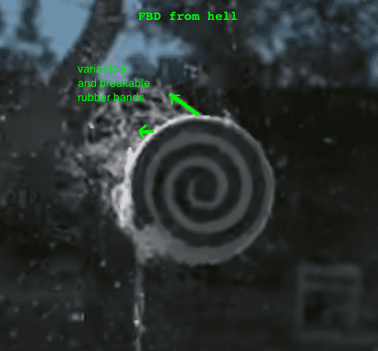

Baluncore said:
I liked figure #1.
It allowed at least a basic free body diagram.
I'm not sure about the effect that the water spinning off the ball has.
All I know is that I don't like Derek's guessed explanation.
@≈3:22
From looking at the high-speed footage, what I really think is going on, is this water getting thrown over and down by the ball, and since the ball is putting a force over and down on the water, that water is putting a force up and in on the ball, which keeps it right in that stream, [etc, etc, etc.]
From my screen captures, most of the water is flung upwards. Which if it weren't for adhesion forces, I would say tend to force the ball down. But due to adhesion, um, I'm not sure.
@≈3:22
There is nothing wrong with his explanation. Any redirection of the water from its initial trajectory is a change in momentum, which requires a force. Even if most water is flung upward, that is still the same as the original direction of movement. That upward flinging is likely slower than the original stream would have been, so the upward water momentum has been reduced, corresponding to a corresponding upward force on the ball or disk. That is what holds it up against gravity.
For the lateral force (and therefore a stable levitation in the stream), the important question is whether more water is ejected away from the stream (corresponding to a force on the water away from the stream and therefore a force on the ball toward the stream), or if more is ejected toward the stream (corresponding to a force on the ball away from the stream). It's pretty clear that more water is being ejected away from the stream when operating at steady state. If the ball moves too far toward the stream, more water is ejected toward the stream, pushing the ball away. If the ball moves too far away from the stream, less is deflected away from the stream, therefore pulling the ball back toward the stream. This is how it is maintaining a stable equilibrium. I am sure there is an inflection point in either direction where, upon crossing it, the ball is now no longer stable.
So based purely on momentum/force pairs, this makes complete sense. Digging into the underlying physics of how the water sticks to the ball and those sorts of questions is where it all gets sticky.

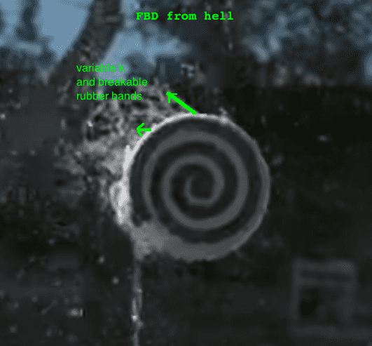

After doing an experiment a few minutes ago, I've decided I have no idea what is going on.
Bathroom sink, since there's snow on the ground outside
The camera was moved between images, so the apparent shift in water stream can be ignored.
Since the spheres are attached to the rubber band with duct tape, they did not spin.
The angles between the water stream and the rubber band are approximately the maximum angle I could obtain.
From that, it may be possible to at least determine the lateral force upon the balls.
But as I said, I now have only guesses as to what is actually going on.
ps. Fun experiment! I'll have to recreate it at the river this summer, when it's NOT 0°C outside.
