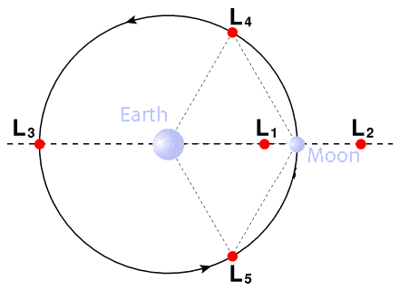

As an analogy, the Earth-Moon's gravitational equilibrium is at Lagrange Point L1, which is about 3/5ths of the way from Earth to Moon, whereas the barycentre of the Earth-Moon system is actually inside the Earth about 1000 miles.
http://citizenscientistsleague.com/wp-content/uploads/2013/03/Feature_1_Fig_5_June_2010.jpg
