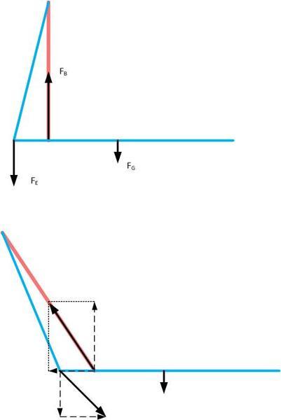

Consider a person holding their forearm horizontally in such a way that the bicep muscle, attached to the forearm at a distance of 4cm from the pivot in the elbow, is vertical. The mass of the forearm is 1 kg and the distance of the centre of mass of the forearm from the pivot is 12 cm. What is the force exerted by the bicep muscle?
(a) 117.6 N. (b) 29.4 N. (c) 9.8 N. (d) 3.27 N.
10. The person now shifts their arm so that the bicep muscle is no longer acting vertically, but the forearm is still horizontal. What happens to the force in the elbow joint?
(a) Nothing.
(b) It changes direction but not magnitude.
(c) It changes direction and decreases in magnitude.
(d) It changes direction and increases in magnitude.
Net sum of torques? Clockwise torques (negative) = Counterclockwise torques (positive)
So I'm pretty sure I got the first question (I chose b). I worked it out by first calculating the force acting on the center of gravity (9.8 x 1) and then using the net sum of torques to figure out the force acting on the bicep.
I'm more concerned with the second question, I know that muscle force is independent of angle but I'm a bit confused as I know that muscle angle does affect muscle fiber length which in turn affects magnitude - are magnitude and force not the same thing in this instance? I know the force of the elbow joint (fulcrum) is acting downwards when the bicep is vertical and I would have assumed that it would stay this way but this is apparently wrong as no change in direction is not an answer. Is muscle angle only independent of muscle force when it is vertical? I'm pretty lost on how to solve this question, at the moment I would assume that a change in magnitude occurs which according to this question means a change of direction occurs as well. I would probably choose (d) just because I feel like the elbow joint would have to exert extra force to make up for the missing bicep force in order to keep the forearm up?

My tip is to make a drawing of the situation in the first question. 9.8 N downward force at the center of mass and 29.4 N upward where the biceps is attached. Biceps is vertical, so force is 29.4 N. ∑F = 0 gives elbow force.
Then a drawing for exercise 10: shift the arm (move the hand forward) such that the elbow angle is obtuse. (Case fully stretched arm is a bit awkward - I suspect the author of the exercise wants to keep the biceps doing the torque balancing)
9.8 N is still there, biceps vertical component still needs to be 29.4 N. But biceps is now pulling at an obtuse angle, so there also is a horizontal component. ∑F = 0 gives elbow force.

The pictures I was thinking of:
In the top one (problem 9?) forces and torques add up to 0.
In the bottom one, FG and the vertical component of FB are unchanged. But because biceps is now pulling in a non-vertical direction, magnitude is bigger than only the vertical component. Elbow now has to compensate for the corresponding horizontal component too.

"But because biceps is now pulling in a non-vertical direction, magnitude is bigger than only the vertical component"?
BvU is saying that the biceps still has to supply a vertical component as before (to achieve the same torque about the joint) but because of its direction it will also have a horizontal component (which does not generate any torque about the joint). Therefore the total force in the biceps is greater than before.
BvU's diagram shows you the answer to the question. You can also get there by considering what change is needed at the joint to accommodate the force change in the biceps.

Ok so I assume that because the total force at the biceps is greater and because the CM's torque/force is constant that the elbow joint's force changes direction to cancel out the horizontal component of the bicep and increases in magnitude to counteract this force increase as well (Answer (d))? When you say the horizontal component doesn't generate any torque about the joint are you saying that it does produce a new torque that for another lever system which means its not counted in the torques of this system? So while the torques/forces of both the bicep are changing direction and increasing in magnitude they are the same as before when it concerns the original 3rd class lever system?
The horizontal component of the force exterted by the biceps at the point of attachment acts through the joint, so generates no torque about it. Yes, it would generate a torque about points not in that line.
