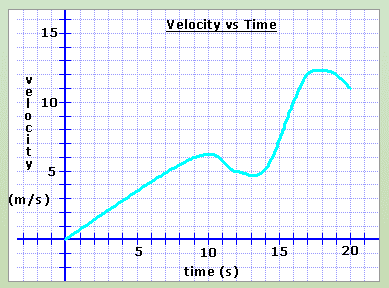

Hey guys I have attempted to solve the question below and hoping to get some feedback. Also, any pointers to solve question 'c' would be really appreciated.
1. Homework Statement
1. A sports car's velocity is shown in the graph below. (Please see the image)
Velocity vs Time graph: velocity in m/s on the vertical axis (0 to 15) against time in s on the horizontal axis (0 to 20). The curve rises roughly linearly from the origin to about 6 m/s near 10 s, dips to about 5 m/s near 13 s, then climbs steeply to about 12.5 m/s near 17 s and falls slightly to about 11 m/s at 20 s.
a. How fast is it traveling at the 5 s mark?
b. What is the acceleration at the 5 s mark?
c. Estimate the acceleration at the 15 s mark. Show your work.
d. During which intervals of time, did the car have a negative acceleration?​
Acceleration = Δv/Δt
[/B]
a. 4.5 s
b. 0.9 m/s2
c. I can't seem to understand this. Not sure what is the initial velocity in this case. Any help would be appreciated.
d. 11, 12, 13, 19, 20
Acceleration will be the slope of the line at any point.
a. Are you sure about 4.5?
b. There appears to be a slight curve in the plot from v=0 to v=5. But it is very slight. So if I assume it is straight from t=0, v=0 to t=7.2, v=5, then I get an acceleration of about 0.7. I'm not sure how you got something as high as 0.9.
c. Same thing as step b. Pick 2 points around the 15s mark that appear to be a straight line that closely represent the slope of the curve at the 15s mark and find the slope of that line.
d. It is asking for time intervals where the acceleration is negative. So, for example, you may say that from t=1 to t=4 the car has a negative acceleration (although what I just wrote is not true.)

Thanks a lot guys. I double checked my work and here are my answers:
a. 3.5 m/s
b. 3.5/5 = 0.7 m/ss
c. I picked two points: 7.25 - 5.25/15-14 = 2 m/s2
d. t=20.5. t=11, t=12, t=18.5, t=19, t=20

If this is a calculus based course what I would kind of do is this...
Graph titled Velocity vs Time, plotting velocity in m/s against time in s, with a black line and a cyan line that closely follow each other, rising roughly linearly to about 7 m/s near 10 s, dipping to about 5 m/s near 13 s, then rising sharply to about 13 m/s near 17 s and falling slightly to about 11 m/s at 20 s.
Now what you have is a series of straight lines instead of the smooth curves. You should now be able to find the equations for those lines, (i.e. to about 9 seconds the equation is just roughly ##v=\frac{2}{3}t##) take the derivative to find the acceleration. For example, at 15 seconds, you have a specific curve that should be easy to find the equation of using any of the techniques in algebra. Take the derivative and you'll find the acceleration for any time on that curve. Your approximate lines should be accurate enough for an estimation.
Alternatively, it might help to plot the acceleration graph on the same graph.
Do this make sense? I know I didn't draw it very well...

Did you see PeroK's comment on D?
Oh I see. So it will be t = 10.5 to t=12 and t=18.5 to t=20?
Looks about right.
If it was me, I would say 10.5 to 13 and 18 to 20. The decrease from 12 to 13 is pretty obvious.
