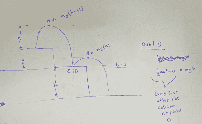

momo1111

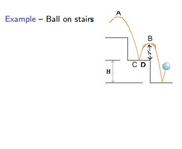

A ball bounces down a uniform flight of stairs of height H , rising after each
bounce to to the level h of the previous stair .
the velocity of the ball before the impact is equal in all the impacts .
what is the average power of energy loss ?
first attempt :
at points A ,B, the ball has just a potential energy, ball’s horizontal velocity seems to be
not relevant (cancel out ).
in A - E = mg(h+H)
in B - E = mgh
EA = EB + Wothers
Wothers = mg(h+H) - mgh = mgh
So the energy loss is actually a constant ...
what I'm missing ?

The energy lost per cycle is constant. So you found the energy lost after one cycle but the question asked about the average rate that energy is lost, so you're not quite finished.Side note: no calculations are necessary to find the energy lost per cycle:
For the velocity to be the same before each bounce, it must lose as much energy in the collision as it gains from falling down the next step. Therefore the energy lost is mgH.

Q : So what is the average rate that energy is lost ?
some scrawling ...
if [itex]mgH[/itex]is the energy lost per cycle ...and if at some point it was [itex]E_0[/itex]then after ...
say [itex]5[/itex] steps it become [itex]E_0 - 5 (mgH)[/itex] ...
so they ask me to find [itex]\frac{E_0-5(mgH)}{5}[/itex] or [itex]\frac{E_0-12(mgH)}{12}[/itex]...?
don't really understand the question .

You need to use H and h to find the duration of each cycle.
How ?
the ball bounce at some parabolic curve .
the time of flight depends on the initial vertical velocity , [itex]v_{0y}[/itex] .
i know that [itex]|\vec v_0| =\sqrt{2gh}[/itex] ,and that it .[itex]|v_{0y}| = ?[/itex] .

Think about the energy between the moment after the collision and the moment when it has risen a height h. What is the change in kinetic energy?

Don't worry about the velocity. A ball is thrown up a height h. How long does it take o reach its highest point? (You need a SUVAT equation that involves t, a, s and final speed of 0.). Then it falls h+H.
