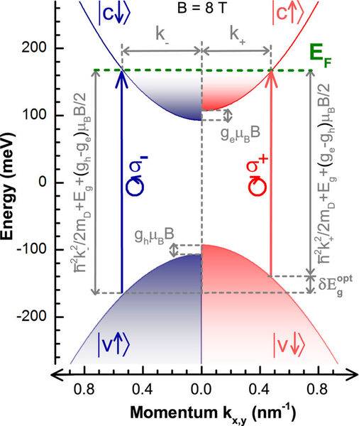

Here's a typical diagram from nature magazine of the net result: The topmost energy level for electrons, is equal on both half bands.
Band diagram of energy versus momentum k_x,y at B = 8 T, showing spin-split conduction bands |c↓⟩ and |c↑⟩ above and valence bands |v↑⟩ and |v↓⟩ below, with Fermi level E_F and σ- and σ+ transitions marked.
If the diagram is accurate, then delta E is around 10 milli electron volts for an 8 Telsa field in whatever secmiconductor they chose (but it really shouldn't matter much). It's not a large difference in energy even though the magnetic field is very strong.
What's interesting, to me, is that they've drawn E_F as a level significantly inside the conduction band. In intrinsic silicon, the fermi level is generally computed to be inside the gap. That's a computation, however, which includes the statistics of electrons from both the conductance and the valence band. It's the average level of all electrons together. In the drawing, the fermi level appears to be drawn as if it was the 50% occupancy point of electrons within a given band. Either that, or the drawing is massively exaggerated for a doped semiconductor.
Perhaps I didn't understand my undergraduate courses on semiconductor physics very well; or the idea of Fermi_level is somewhat abused in the literature. :D
I would expect there to be two different E_F's one for electrons, and one for holes for the drawing shown by nature magazine.
Is it possible that the ARXIV authors, and the early cyclotron experimenters, mean something like "quasi fermi level" with respect to what a cyclotron usually measures?
