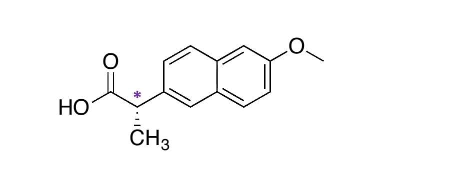

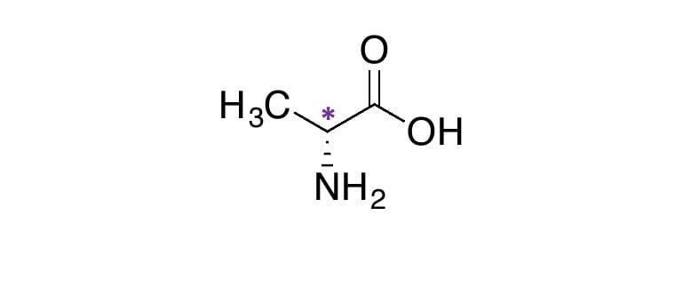

Hi. Can someone tell me which molecule is R or S?
For me, the first one is S and the second one is R.
244942
Chemistry news on Phys.org
I think the first is R and the second is S.
Can you explain how you arrived at your answers?
Yes, it’s correct.
Basically the mistake I made was that I gave the first priority to COOH instead of NH2 in the first molecule, whereas in the second one I forgot to switch from R to S.

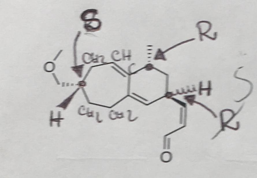

Okay, I have another doubt.
Why the carbon on the right is S and not R?

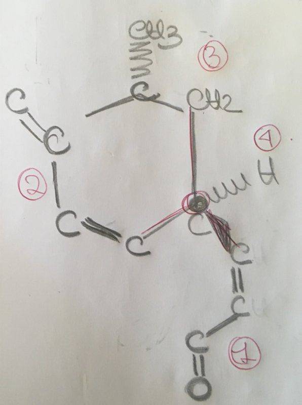

Aren’t the priorities like this?

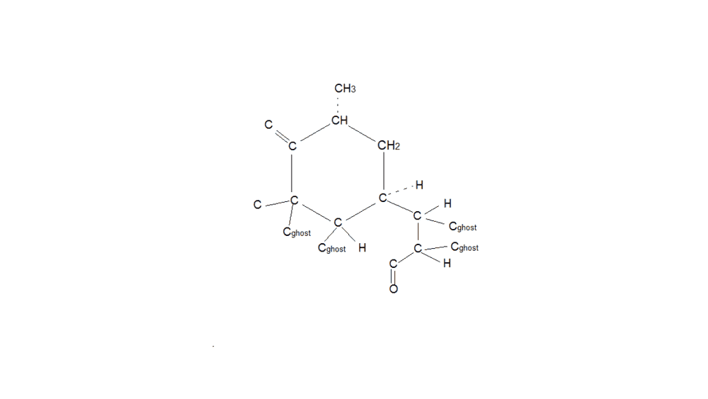

You've forgotten the other C atom on the C 2 atoms from the stereocentre on the chain you labelled 2.
Okay, but isn’t the priority still the same?
No, that C trumps the H on C2 on the other chain.
If it’s not too much of a trouble, could you redraw the molecule?
mjc123 said:
Thanks a lot! So basically I switched no.1 and no.2 in terms of priority.
